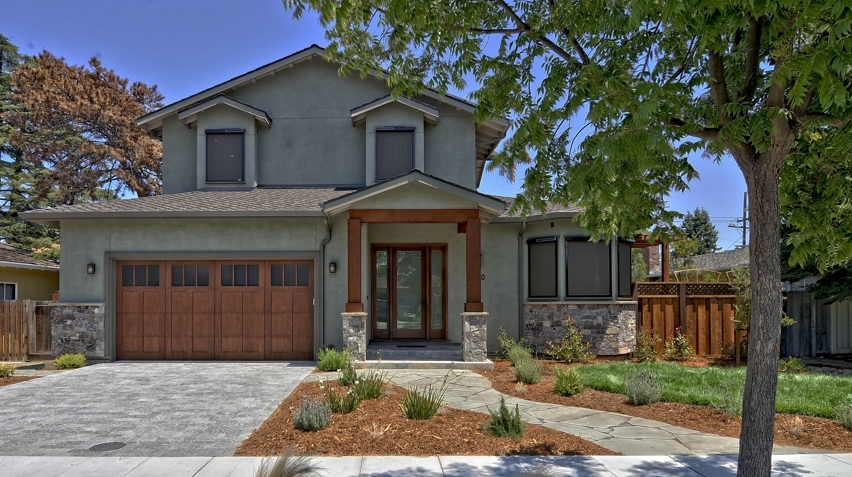

ICFs and advanced framing techniques used throughout
This energy-efficient house in San Jose, California, not only produces enough solar electricity to meet its annual energy needs, it also complies with the stringent Passivhaus standard.
The design-build team of Allen Gilliland and Bronwyn Barry of One Sky Homes were behind the spec home and succeeded in meeting the Passivhaus standard and the performance requirements of the U.S. Department of Energy’s Zero Energy Ready Home program.
To meet the DOE Zero Energy Ready Home criteria, the home had to meet the requirements of the Energy Star Version 3.0 program and comply with the minimum insulation requirements in the 2012 International Energy Conservation Code. The DOE program also requires that homes be certified to the air quality requirements of the U.S. Environmental Protection Agency’s Indoor airPLUS program. In addition, the builder chose to pursue LEED for Homes and achieved platinum certification on the home.
Home took four years to design and build
The $1.1 million house could be thought of as a building science test project. The 3,198-square-foot, two-story spec home took four years to design and build, more than twice the builder’s typical construction cycle for a custom home, because Gilliland wanted to test several new construction techniques.

Thanks to rigorous air sealing measures, the home was able to meet the very low air leakage target required to meet the Passivhaus standard (0.60 air changes per hour at 50 Pascals pressure difference). The blower-door test showed that the home has an air leakage rate of 0.57 ach50.

Blower-door test results: 0.57 ach50
Estimated energy use: 10,000 kWh/year, of which 2,000 kWh is for heating and cooling
Estimated annual utility costs: Without PV, $1,972; with PV $0.
Estimated annual energy cost savings: (When compared to a home built to the 2008 California Title 24 Energy Code) Without PV $1,095; with PV: $2,900.
Actual annual energy use (2013): Not counting the electric vehicle, the house used 9,325 kWh. PV production exceeded use by 1,492 kWh. Including electric vehicle charging, the PV array produced 84% of the total site electricity consumption.
