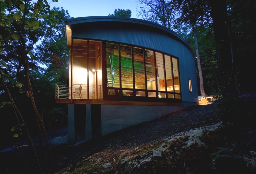

Image Credit: Jim Burton VIRTUALLY OUTDOORS. On top of adding warmth and light, the custom floor-to-ceiling windows make the small studio feel downright spacious. They were built by a local craftsman from local lumber. In fact, all of the materials — including the poplar flooring and paneling boards that initially formed the curved foundation walls — were sourced from within a 30-mile radius. Hidden bed hatches in the floor are barely noticeable when closed.

Image Credit: Jim Burton RESPECT FOR THE SETTING. Nearly every surface of the studio is curved. This adds strength to the structure and softens its visual impact on the natural surroundings. Careful site work meant that the project's area of disturbance barely extended past the foundation's edge.

Image Credit: Jim Burton AN INTERESTING MIX OF MATERIALS. Hand made and high tech details work side by side in this inventive space. The corrugated metal siding, often found on barns in this region, is employed in a more sleek and contemporary way here. SIPs made sense, not just for their good sealing and insulating qualities, but also to efficiently form the gently curved walls and roof. Soy based foam insulation, locally harvested, reclaimed wood, and air cleaning TXactive cement are just a few of the materials that were chosen for their environmental merits.
