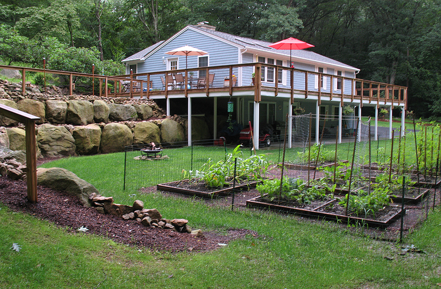

When selecting a home, first impressions are the most important factor, after price and location. With this in mind, owner/contractor Mike Guertin took extra care to landscape his spec remodel attractively. To add visual interest and manage runoff, he built terraced walls around the lot from stone he found on site. He reclaimed some of the plantings from the original overgrown landscape and incorporated native species.

After determining how much work the site itself would require, Mike relocated salvageable plants to another area and stripped the topsoil for later reuse. His cut-and-fill approach to terracing the slope created flat space for play areas and a garden. The work also slowed runoff, giving rain an opportunity to percolate into the earth. Since overdevelopment in the neighborhood has reduced recharge of the natural water table, and since the home is served by a 14-ft. well which runs dry during extended droughts, the extra percolation provided by Mike’s landscaping improvements is particularly valuable.
The rocky site had plenty of stones that were of the same size as stone walls in the area; they were perfect for a planned retaining wall. Larger boulders that couldn’t be moved were broken by hand into smaller pieces. The edges along the stone walls and on the flat terrace steps were covered with landscape fabric and bark mulch to inhibit weed growth and promote water percolation. Mike used soil cut from the terraces to raise the grade above the stone retaining walls and level off areas for lawn and plantings.

Mike used nontoxic silica-treated lumber to frame raised beds for a vegetable garden. Lawn areas were left to grow on their own; self-seeding native grasses took over the areas after several months. The lawn needs no watering and infrequent mowing.

Code and life safety
If the close up of the rail in the left forefront is indicative of the handrails overall, the system on the deck is grossly unsafe. Balusters with maximum spacing of 4" are required for obvious safety reasons. Unless there are clear panels up there that are not obvious in the photo, what happens to the child running or riding their tricycle when they go over the edge?
Railing Infill code compliant
In response to Jim / Code and Life Safety:
The railing infill is a 1 3/4 in. dark colored net matrix with 600 lb strand strength and 1350 lb load rating for one square foot area. It was selected because the owners wanted a less obrusive alternative to wood balusters.
