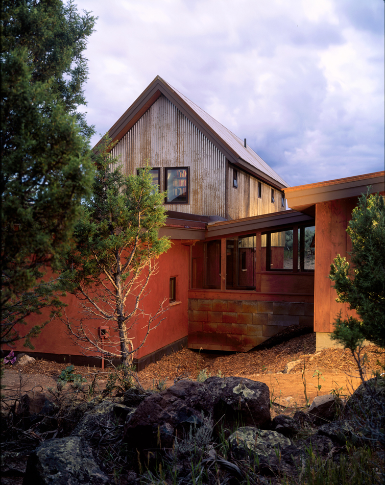

Our house is located outside of Carbondale, Colo., at an altitude of 7,000 feet. The architecture is both responsive to the climate — a dry mountain environment — and reflective of the local mountain style. I’m an architect, and I designed the house to be as energy efficient and environmentally friendly as possible within a reasonable budget. Of course, my wife and I, both self-employed professionals, also wanted a wonderful space to live and work in. The use of natural materials has made it a warm, cozy and comfortable home.

The main structure is elongated along the east-west axes and faces true south. We constructed it on an abandoned road running through the site and worked around the existing vegetation. Our driveway follows the alignment of the abandoned road; what vegetation that was removed was ground up and used as mulch. The property is rural in character, yet is located less than ten minutes from a major highway and commercial center.

During the design process, computer modeling showed a 3º to 5ºF temperature swing in the house year-round without the use of conventional heating or cooling systems. The calculated temperature swing has proven to be correct. The temperature in the house during the cold winter construction, when outdoor temperatures were below zero, ranged from a low of 35ºF to average daytime highs of 50ºF plus. Minimal supplemental heat was used during two extremely cold weeks of construction in January. The house maintains 72ºF to 76ºF interior temperatures during 90ºF degree summer days.

A majority of the project goals were achieved, and our house is exceeding its performance goals. The only thing I would rethink is the use of the water storage tubes in the greenhouse because they tend to collect condensation, which drains off onto the slab below. Even though I have provided drainage for this, the tubes sweat enough to actually raise the humidity in the greenhouse. They also sit too close to the north wall and would benefit from more air circulation around them. It might have been better to use a solid exposed concrete wall, insulated on the exterior, as thermal storage for the space.
I would also reconsider the interior finish and use a more durable metal or cement board on the walls; I used a water-resistant gypsum wallboard, but there are now paperless gypsum wallboard products on the market that would hold up better under such moist conditions.
