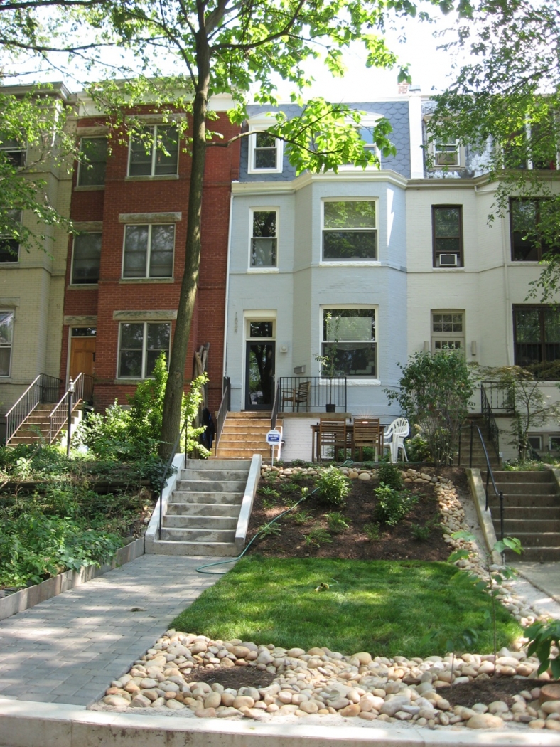

Green realtor Amy Levin uses her background in construction, housing market savvy, and sheer will to achieve Platinum on her LEED for Homes gut rehab of a DC rowhome
“It was easier than I thought,” says Amy Levin when first asked about her LEED for Homes Platinum gut rehab. This would not be the last time my jaw would drop when dealing with Amy; she is a completely unflappable, sharp as a tack, force of nature. She is a born problem-solver and her favorite retort is most certainly “why not” rather than “why.” The devil is always in the details; here is the rest of the context on Amy’s “easy” version of LEED Platinum.
Using the LEED for Homes checklist to drive the process
Amy used the LEED for Homes rating program and checklist to drive her own green building learning curve as well as her design and building process. “I had done some green building in the past,” recalls Amy, “but it was not a comprehensive or integrated process. We did not use the LEED for Homes checklist as prescription, we used it to learn, evaluate, and prioritize. The LEED for Homes program checklist is a really great organizational tool.”
“While this approach is not the ideal, it is quite common and can work” says Asa Foss, Amy’s LFH rater, her primary green building consultant and now Manager for LEED Technical Development at the USGBC. “The danger in having the checklist in the driver’s seat is turning your project in to a point-chasing exercise. While point-chasing was definitely not an issue with Amy’s project, it’s an important hazard to avoid.”

Making the numbers work
While Amy had a substantial budget for her project, it was definitely finite: “My budget was $500,000 and we came in at $495,676.92. I kept expecting the green building BigFoot to come and crunch the project, but I really believe that there was no real premium. Think of it this way: my apartment rental income covers more than what my mortgage would be on this project. My peak monthly utility bills are less than half those of my neighbors, and my home is more comfortable with better air quality.”
Amy is clear that some individual components came at a premium: higher SEER AC unit, her solar water system, top-of-the-line household appliances. But here is a list of project elements where she is sure she saved money going green: a salvaged kitchen cabinet and granite countertop for her rental unit kitchen ($500), powder room vanity made from site-salvaged lumber ($50), river-run fieldstones for front yard landscaping (free from her 4 feet of basement excavation).
And as a realtor, Amy is confident she can take the value of her LEED Platinum project with her if and when she sells her home. “There is real value here that I can show, from the comfort and health perspectives, but also by simply sharing my utility bills!” says Amy with a smile.

Lessons Learned
Amy was not particularly fond of being a green guinea pig for some of her materials. “The Columbia Forest Product Purebond door on the largest cabinet never worked; it warped badly,” says Amy, "and we finally just had to replace it.“
“I also completely underestimated the need for residential lighting design,” adds Amy. “We got energy-efficient lighting products, but the location of lighting is sometimes an issue and also the balance of task and background lighting is wrong.” Amy wishes she had known about residential lighting design guidance from IBACOS (High Performance Lighting Guide) and from RPI (Builder’s Guide to Home Lighting).
“Frankly,” says Amy, “it was the regular headaches that had little to do with green that I wish I could do over again, like finding the right plumber!” Amy wrapped up by saying how hard it is to figure out the right way to “divvy up” four stories of a rowhouse between the rental and the live-in portions.
