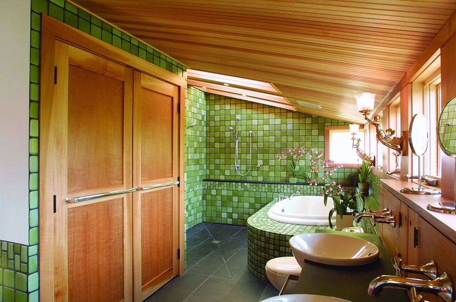

**Transformed from a dark attic,** this sunny bathroom addition benefits from lots of light and tasteful materials including a recycled chalkboard-slate floor, recycled-glass wall tiles, and a beadboard ceiling of sustainably harvested cedar. The wide-open curbless shower features two shower units and a shelf capped with slate.

**Convenience concealed.** One big goal was to bring amenities closer together. The bathroom and laundry, both formerly downstairs, are now combined in one efficient space. Swing-away cabinets hide the washer and dryer from view, leaving an otherwise simple and tidy space. **Great, guilt-free materials.** Towel bars and other bath hardware are all made from recycled aluminum. Storm-felled Pacific madrone trees provided the wood for the cabinets and backsplash; the vanity counter is made of Richlite, a material made of kraft paper and phenolic resins.

Leslie and Heather wanted the new construction to harmonize with the traditional style of their old house, but they also wanted unmistakably modern features such as a large tub, a curbless shower, and stylish sinks. They also challenged us to make the project environmentally responsible. The resulting design is a mixture of salvaged schoolhouse blackboards, antique light fixtures, and a beadboard ceiling that contrasts with the sleek lines of the plumbing fixtures.
Despite the number of features that are packed into the bathroom, the room still feels open and spacious. Skylights and a row of windows above the bathtub fill the room with daylight, while the sills are high enough to provide privacy.
The washer and dryer are also in the bathroom, so to avoid a utility room feel, I designed a closet with shelves on the doors’ interiors. When the closet doors open, an instant laundry room is created. When they are closed, the machines are out of sight.
