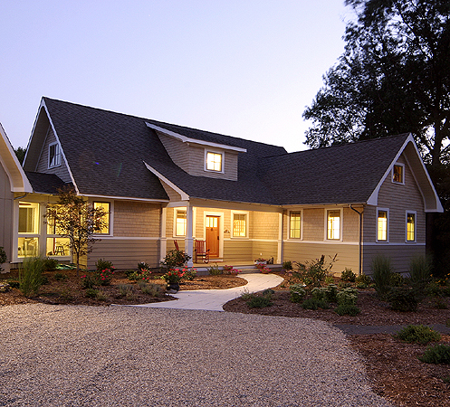

Image Credit: Russell Campaigne The angles of the house and garage create a funnel that draws cool breezes through the screened porch. Solar panels are in an inconspicuous location, high on the south roof.

Craftsman bungalows are celebrated for being comfortable, practical and carefully crafted from local natural materials. This LEED Gold home in South Glastonbury, Connecticut, incorporates all of these qualities and more. To meet the homeowners’ goal of creating an enjoyable and economical place to retire, CK Architects penned an attractive, efficient, and adaptable plan. A meticulously detailed building envelope, a discretely mounted photovoltaic array, and a ground-source heat pump keep the home affordable.
Let nature work for you
Beneficial natural conditions paired with good design choices helped maximize the project’s sustainable features. An L-shaped house plan and a central screened porch let cooling breezes pass right through the house. An existing clearing made it easy to install the horizontal heat-pump loop and then cover it with a meadow of wildflowers. The landscaped portions of the site contain large beds of noninvasive, drought-tolerant plants, minimizing the need for irrigation and yard work.

Farmed white cedar shingles, fiber-cement siding, and cellular PVC trim ensure that the home’s exterior is low-maintenance and durable. CK Architects left the core living area open with plenty of south-facing windows, creating a bright, functional, and efficient space. Less frequently used, the guest rooms are deliberately isolated from the rest of the house, allowing John and Karen to reduce their heating demands when visitors aren’t around.

He also found that the screened breezeway performed better than expected. Shade trees and the funnel shape of the house made it much cooler in summer and there was plenty of solar gain to help break the chill in the early months of spring.
