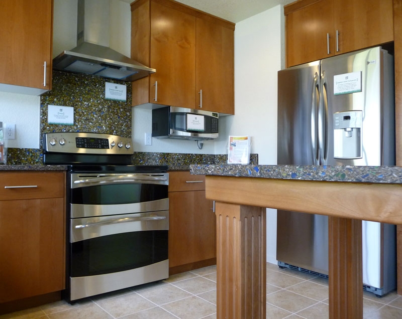

• Replaced refrigerator with Tier 2 Energy Star (25% better than federal appliance standards) and dishwasher with Tier 2 Energy Star (.69 energy factor, 50% better than federal appliance standards);
• Control 4 Home Area Network controls HVAC and lights, monitors home’s energy use and solar PV electricity production w/green switch.
• Refrigerator and range are Energy-Management-Enabled for future "smart grid" interaction.

• Air King Energy Star—rated range hood and bathroom exhaust fans on timers

• Locally produced, no-added-formaldehyde cabinets
• Recycled-content kitchen and bathroom countertops
