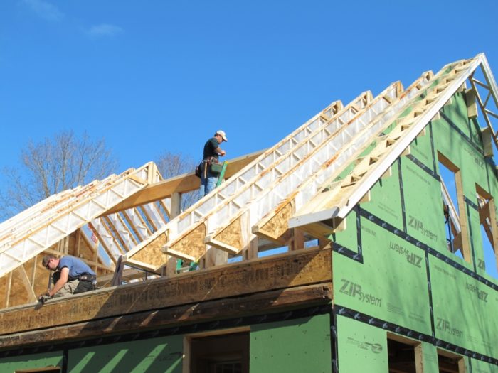

Open-web Triforce rafters being installed on our house.
Image Credit: Alex Wilson

Prepping rafters for installation. We added raised heels to gain additional space on the second floor.

Fabrication detail showing how loads extend down through the 2x6 "heel."

Finding deep enough rafters
To achieve the 16-inch depth we wanted for insulation and an air space under the sheathing, we used open-web, parallel-chord trusses as the rafters. These trusses, typically used as joists, have diagonal bracing or “struts” and are made in Quebec by Open Joist Triforce.
Unlike most parallel-chord trusses, Tri-Force uses solid wood, rather than OSB, and finger-jointed glue joints rather than metal truss plates for attaching chords and webs. Some experts are concerned about the long-term durability of OSB webs in more common I-joists and the metal fasteners in standard roof trusses.
The chords on Triforce joists are either 2x3s or 2x4s, and the diagonal struts are solid-wood 2x2s, allowing vent baffles to be attached to the top chord (providing a 1-1/2″ vent space). Connections between the struts and chords are achieved with precision-machined grooves and polyurethane adhesive. The wood is all northern, slow-grown spruce, rather than plantation-grown southern yellow pine or poplar.
Triforce joists include a section of OSB at the ends so that the length can be adjusted. This permits manufacturing in standard lengths and keeps the costs down.
Providing a stem wall and roof overhang
In our case, to expand the living area in the upstairs of our compact house, Eli Gould added “raised heels” to the roof trusses. The OSB tails on the Triforce rafters made this fairly straightforward, though it certainly involved some additional labor. The design at the roof eaves also provides for nearly two feet of roof overhang — a high priority in keeping moisture off the wall and away from the windows and foundation.
Despite the extra work with the raised heel and overhang, the rafters went up quickly. Eli’s crew worked all day on the Saturday before Superstorm Sandy came through to get the roof up and sheathed with Huber’s Zip sheathing (with joints taped). They were able to keep everything remarkably dry.

    Minor detail. In the photo of the "raised heel," is there solid blocking directly under the web rafter or are the vertical 2" x 6"s (raised heel) notched around the bottom chord and butted up against the underside of the top chord? Otherwise it would seem the roof loads would rely solely on the shear strength of the nails/ screws. Just curious.
  2. Alex Wilson | | #2
    Structural loads at the rafter heel
    Dave,
    I added another photo that shows the construction of the rafters more clearly. I hope that answers your question. Timber engineer Ben Brungrabber, P.E., Ph.D., has been advising Eli on structural design issues with this new application of parallel-chord trusses.

    The picture does clarify how the load is transferred to the plate. Just my 2 cents but I'd jam a solid block directly under the rafter and in between the two 2x6s. I've been told I have a tendency to overbuild though....

    Yes, we plan to attach plywood (or some other material) to the underside of the top chords. I don't think we've decided on the baffle material, and I'm not sure what the air-sealing plan is. Do you think the plywood (or other material) needs to be air-sealed to the rafters?
    Dave, I'll make sure that Eli sees your comment on blocking. I'm not sure exactly how that was handled.

    I would think that raised heel would need to be engineered because it converts the vertical load to a shear load between the truss and the vertical 2 X 6 legs; due to the inclined contact between the top of the legs and the bottom of the top chords. The resulting shear load is borne by the nails, perpendicular to them. That shear load will try to tip the tops of the legs toward the ridge line.
    I was once told that the engineered portion of the truss had to bear in a horizontal plane upon the tops of the studs. So, in this case, the engineered portion of the truss includes the raised heel legs.

    In reviewing Dave’s question in post #1, the nails would obviously be carrying the entire load in shear if the truss did not bear on top of the pair of short studs. But the one photo added to respond to his question makes it clear that the truss does bear on top of the studs.
    However, the nails are still carrying a significant portion of the load in shear as a reaction load. In other words, if this were assembled, and the nails were to magically disappear, the 2 X 6 studs would move with slippage along their sloped contact with the truss.
    Normally, I would expect this detail to be made by having the studs support the truss with the point of contact being in a horizontal plane. With a manufactured scissors truss, the heel of the truss is made by running the bottom chord horizontal for a short distance at the wall support point. And that horizontal portion is properly supported by a strut from the top chord. So the horizontal feature of the truss is part of the engineered truss. It seems to me that the open web trusses used in this house would require the same type of horizontal feature that would be an integral part of the engineered truss.
    But without that engineered pedestal feature of the truss that would provide a horizontal load bearing surface, a builder would need to custom build it as is the case with these truss rafters supported by the 2 X 6 studs. And that custom work would need to be engineered to account for all the forces. I would think that the connection would require something like 2 x 2 cleats screwed and glued to the bottoms of the top chord in a way to prevent the 2 X 6 studs from tipping toward the ridge as a reaction to their vertical loading through the sloped contact surface. Such cleats would take all of the shear loading off of the nails.
    I do not fully understand how this detail is executed at the ridge, but there, the reaction force on the studs opposes the same force from the opposite side of the ridge. So if the short 2 X 6 studs on each side of the ridge were contacting each other, they would each compensate the other’s reaction force. I cannot tell from the photos if they are contacting each other.
