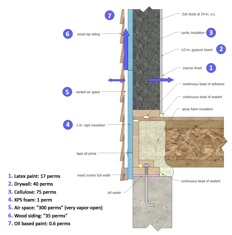

Example 1:This wall can dry in and out. Interior moisture can dry inward and water that gets behind the siding can drain and dry because of a vented air space. Example 2: This assembly has little to no drying potential in either direction and presents a real moisture problem potential, almost regardless of indoor and outdoor conditions.

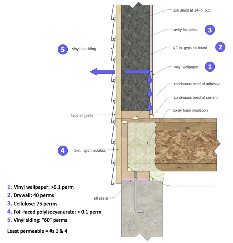

Example 1 – an acceptable vapor profile
In this example, we have taken a representative GBA wall construction detail and assigned actual materials for each component of the assembly.
Step 1: Assess vapor permeabilities
How do you determine the vapor permeability of your building materials?
In this example, all of the numbers came from the BSC table mentioned earlier.
Note that two numbers are in quotes. In the case of the air space it means that vapor moves so freely in air that it is as vapor permeable as it gets.
In the case of wood siding, the quotes indicate an “equivalent” vapor permeability. This means that although the lab test of a piece of wood siding (pine, in this case) may yield a vapor permeability of around 2.5 or so, all the gaps between the installed wood clapboards in a wall assembly permit enough air circulation in between clapboards that the effective permeability is MUCH higher (35).
NOTE: If you can’t find the numbers you need in this table, you will have to search the Web or contact the manufacturer and tell them you need this information or you can’t use their product. That should get their attention.
Step 2: Identify the least permeable component
After you have all the numbers, it is pretty easy to pick the one, or maybe two, most restrictive layers in the wall assembly, in terms of vapor permeability.
Note that 1 inch of XPS insulation at 1 perm is NOT vapor impermeable. However, it is the most restrictive, which means that MOST drying will take place to its interior or exterior. Also note that the near vapor impermeability of the oil-based paint is managed or overridden by the air space and the functional or equivalent vapor permeabilty of the wood siding as installed (with lots of little air gaps).
Step 3: Assess the vapor drive(s)
We don’t know what the interior and exterior temperature/relative humidity regimes for this assembly are; we have not picked a location or interior conditions — but…
Step 4: Assess storage and drying capacity
…since there is such great drying potential on either side of the XPS, this assembly is well-suited to a wide range of climatic, site, and interior conditions.
Example 2 – An unacceptable vapor profile
In this second example, we have another representative GBA wall construction detail and again assigned actual materials for each component of the assembly.
Again we have taken vapor permeability numbers from the BSC Building Materials Property Table.
We have two layers that are essentially vapor barriers, stopping all moisture from getting INTO and OUT OF the wall assembly. And the problem is that the two layers encase much of the building assembly.
Steps 3 and 4: Assess the vapor drive(s), storage, and drying capacity
Even without assessing the vapor drives, this assembly is likely to be a problem in ANY climate or interior conditions. If (or rather when) this assembly gets wet, it has very little drying potential. It would take nearly perfect design and construction details and very little moisture drive to keep this assembly from failing.
Let’s look more closely at Step 3 (keeping the assembly from getting wet) and Step 4 (letting it dry when it gets wet). If at all possible, we want to change one of the two restrictive layers to give the assembly more drying potential. But which one?
If this building is located in the hot-humid south, where the prevailing vapor drive is from the outside in, it is probably better to keep the foil-faced insulation and lose the vinyl wallpaper.
If this building is located in the far north, where the prevailing moisture drive comes during the winter from the inside, we might want to pick a rigid insulation product that is more vapor-permeable.

  84. user-1028260 | | #84
    what is the point of the foil on the polyiso foam?
    Can someone please explain to mean what the effect of the foil is on the polyiso. foam in the particular application of example 2?
    I was taught in Thermodynamics that radiation only occurs in open space, so a radiative barrier (such as the foil on the polyiso. foam board) only works when it is "facing" an open space. In other words, through solid assemblies, conduction is the only heat transfer mechanism. If that is correct (which I have heard repeatedly from my professors), then it seems that foil-faced rigid foam boards (of any type - EPS, polyiso., etc.) hurt more than they help, because they often create an unintended vapor retarder on the wrong side of the assembly (or inside the assembly as I often see in Alaska, when people use foil-faced EPS inside their box headers).
    Will the more experienced among us please clarify this situation?
    Thank you.
  85. GBA Editor
    Martin Holladay | | #85
    Response to Lyle
    Lyle,
    First of all, Example 2 is an example of what NOT to do. So the wall assembly is being discussed to make a point. It is not being proposed as an example to follow.
    Secondly, the foil serves two main purposes:
    1. It is an air-impermeable facing that slows or stops the migration of blowing-agent gasses from the tiny bubbles inside the foam. This maintains the high R-value of the polyiso over time.
    2. If it is installed adjacent to an air gap, the foil can raise the R-value of the adjacent air space and thereby slightly improve the thermal performance of the wall or roof assembly.
    Many builders use foil-faced polyiso even when it isn't adjacent to an air space, because it is an environmentally friendly foam with a high R-value per inch. Polyiso with another type of facing would work equally well in such an installation.
