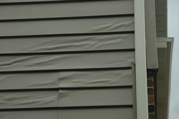

In almost every corner of the U.S., reports are increasing of vinyl siding that has been melted by sunlight bouncing off nearby windows. This melted-siding pandemic makes vinyl manufacturers very nervous — so nervous that the topic is rarely discussed.
Most reported cases involve siding that melts, gets replaced, and then melts a second time. One possible reason for the apparent increase in cases of melted siding is the increasing use of high-performance glazing.
Not our problem, says Pulte
Arlene Taraschi, a homeowner in Delanco, New Jersey, described her melted siding in a letter to a Q-and-A column in the Philadelphia Inquirer: “Two years ago, my husband and I purchased a new, Pulte-built home in South Jersey. After a few months we noticed the vinyl siding on one side of the house seemed to be dented in a diagonal pattern. The siding contractor replaced the siding on the entire side of the house. This was done last January, and by February the denting pattern began again. We were told at this time that it was because of the reflection of the sun’s rays from our neighbor’s house. Pulte has termed this melting of the siding ‘thermal distortion,’ and refuses to correct the problem.”
As Taraschi’s case makes clear, these cases aren’t just public relations nightmares — they’re legal nightmares. Arlene’s husband, Carl Taraschi, told me, “I’ve sued Pulte, the siding installer, and the siding manufacturer.”
Since 2007, when I first reported on cases of siding melted by window reflections, I’ve collected homeowner reports of the phenomenon from 16 states (Connecticut, Georgia, Florida, Illinois, Iowa, Maine, Massachusetts, Michigan, Minnesota, New Jersey, North Carolina, Ohio, Oregon, Pennsylvania, South Carolina, and Washington).

This morning I received an e-mail from a homeowner who read this blog and provided an update on her own vinyl siding problems. Joanne from North Carolina wrote:
"As of May, 2010 we finally have our house looking good again. At our own expense and with the approval of both adjacent homeowners, we paid to have the problem, high-E [I think she means low-e] windows replaced in the homes that are on both the east and the west side of our house.
"The windows were replaced in December, 2009, and we waited a few months to see if the reflection problem had been solved. I believe most of the damage is done in the winter when the siding is cold and the reflection from the windows on the siding makes a huge difference in siding surface temperature. Then in May, 2010 we hired a vinyl siding contractor to replace the vinyl siding on the east and west of our own home. The siding job was finished in May, 2010 and still looks good.
"It ended up costing a few thousand dollars, but we felt we had no choice. Our option would have been to re-side the entire house with a siding product like HardiPlank (which would have been even more costly)."

As I'm sure you know, these cases usually involve negotiations with neighbors. In such cases, the window owner usually experiences no problems.
While some homeowners don't mind changing the appearance of their windows to help out their neighbors, others balk. "If my neighbor chose to install a siding with a melting point of 165°F, why is that my problem?"
Moreover, your solution lowers the solar heat gain through the window. While this will probably be seen as a benefit to a Florida homeowner, it would definitely be a disadvantage for a homeowner from Maine or Minnesota, where solar heat gain through windows is desirable.
Your solution means money out of the pocket for northern homeowners, who will see their heating bills rise after the solar screens are installed.

"The insurance company ended up hiring an engineering firm to do a site survey and they confirmed it was the windows. So I replaced the siding, for a second time, and then the insurance company went after the [neighboring] homeowner personally from what I understand. The window company even admitted that their windows caused the melting. It was an odd claim and everyone in the beginning laughed at me but in the end, I was able to prove it.
"The article was very interesting but the one thing that I question is whether the rays being reflected contributed to my cataracts. At age 37, I developed severe cataracts which was unexplained but my office and desk sit right in front of that window where the siding was damaged. Just makes me wonder now if there is any correlation.
"I think the insurance company went after the homeowner personally because I sued her in small claims court, not expecting to win, but to simply establish knowledge and document her and her insurance company’s refusal to do anything. Cardinal [Glass] was pretty good and was willing to install the screens on ALL her windows, not just the ones affecting my siding. In all fairness, Cardinal tried to work with the homeowner who consistently refused and contributed to the problem as well as the delay in its resolution."

When a builder accepts a contract to install siding on a house, that contractor is in effect telling the homeowner that the installed product is suitable for use on houses.
Later, the product melts. According to the neighbor's lawyer, window reflections are a common fact, and any siding should be able to withstand normal temperatures, including the temperatures that occur when reflections hit the side of a house.
I'm not sure what the lessons are here. One possible lesson is that siding that melts at 165 degrees F may be a risky siding to install. Contractors may want to think about that when they give advice to homeowners.
If the fact that vinyl siding melts so easily makes you nervous, maybe you shouldn't install vinyl siding.

There is absolutely no evidence that foil-faced foam sheathings cause any problems behind vinyl siding. After all, the foil facing is always in the shade!
The only problem with foil-faced foam sheathing might happen when your NEIGHBORS install it on the wall of a house under construction, causing reflections to hit your vinyl siding.

In my first article on this problem (an article that appeared in the April 2007 issue of Energy Design Update, this is what I wrote about the question of distance:
"Some experts note that vinyl siding must be 'just the right distance' away from a window to melt. In fact, cases seem to fall into two distinct categories. About half the cases involve what EDU calls a 'zap-the-neighbors' window, with the distance from the window to the melted siding measuring about 35 feet. The rest of the cases involve an inside corner of an exterior wall, with a window oriented 90 degrees to the melted siding; in such cases, the distance is usually less than 8 feet."

The heat transfer method we are dealing with in this issue is radiation. All radiant heat does not stop when it hit the first surface, some of it penitrate the surface and could then be reflected back into the siding. if this is not true then there should be no reason to use foil faced product anywhere in a house.
Being an engineer that has set up experiments to test products, sometimes a little change like the type of insulation or if there is a fan in the room, can change a product from being acceptable for all application and being a complete failure.

Given the patterning effect visible in the photographs I doubt that foil-faced insulation is primarily responsible in these instances. I suspect though that reflective foil may well contribute to premature failure of vinyl siding in other ways by rendering it brittle and more liable to general mechanical damage. We have seen many instances of wood siding affected in this way: in an exterior remodel our contractors often try to save sections of the original siding for patching purposes but if foil-faced sheathing has been used the boards will generally shatter as they are removed.

Radiant energy is stopped by any opaque (solid) object. No radiant heat energy passes through vinyl siding. What happens is the radiant energy hits the siding; then the siding softens and melts. But radiant energy cannot pass through the siding and magically hit the foil-faced siding behind it. The foil-faced siding is always in the shade and never sees any radiant energy from the sun.

I have the melted siding issue here at my house in Edwardsville IL. Never believed it was a reflection. CertainTeed is the manufacturer. Battled back and forth on the issue, they finally just sent me some siding. Replaced it and the warping happened again that winter. Neighbor noticed it happening, next morning walked out there to evaluate and notice this small but very bright reflection on the house. Never noticed it before because I guess I am never really outside in the winter months early in the morning. Would not have believed it if I hadn’t seen it with my own eyes.
Now how to fix it? Helpful neighbor but can’t think of anything except to plant a large pine tree but hate to have that right there. Can’t use a screen as this is the top fixed section of the window, no place to put a screen.
Response to Clay Shaw
Clay,
Thanks for the great photo. Unfortunately, there is no simple answer to this dilemma. I don't recommend legal action, in general, because no one will win but the lawyers.
In many cases, replacing the window (or just the sash) will solve the problem, assuming that the window glazing that is now installed is somewhat concave. Perhaps you can work out a deal with your neighbor if you offer to pay some or all of the cost.
