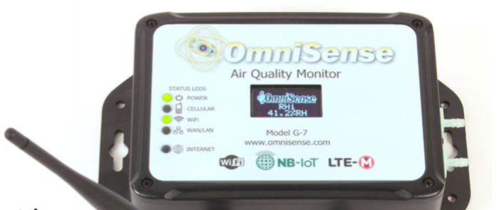

My friend Jake has a great saying: “Trust but verify.” In terms of building, this means we can exercise our skills in material choices and how we assemble them to make something that we believe wholeheartedly will work. But unless we take some sort of step to actually measure and quantify performance, how will we ever be sure? How will we ever diagnose? How will we ever improve?

This is very informative, thanks for sharing. The written sensor placement description is helpful, and I'd be very interested to see a schematic showing "typical" sensor placement locations and quantities as well.
Are there any PM2.5 sensor that tie into OmniSense or other systems? I understand there are questions about accuracy/longevity of consumer PM2.5 sensors, but I'm curious nonetheless. If OmniSense starts selling one, I shudder to imagine the cost if a single CO2 sensor is $300. I suppose in the end CO2 is probably correlated enough with PM2.5 to do the trick in most situations.

I've got a few Lascar units going for temperatures, humidity indoors and out, as well as monitoring ground and slab temps in my project....but still searching for a wood moisture datalogging solution.
IF you're game try to get tjhe spec's on that sensor, I bet it can be made to run off a Raspberry Pi, or Arduino. The latter is ideal for data collection. Go to adafruit.com to see the collection of sensors that are available. They don't have the WME sensor but most everything else.
Right, my point exactly, the WME sensor is hard to find. Seems almost absurd that we have so many other sensors available, but not many choices for WME. There are tons of options for temperature and humidity dataloggers, and relatively inexpensive (<$200). Wood moisture datalogging? Not so much.
The thing is, one can chose between a slew of moisture meters for about $25, and most of those work reasonably well. Adding datalogging to that shouldn't be too difficult, but apparently is TOO niche a market to have something out there.
I'm trying to avoid making my own, especially when I want 2-4 sensors in 2-3 buildings, one of which is a couple hundred miles away. Been doing some research on this, and if I don't find a ready made solution soon, seems the best thing is going to be to to "implant" moisture meter "spikes" in sheathing in walls at the right spacing, and run wires to a connector somewhere outside the wall, and check manually with a handheld moisture meter when I think of it. Since the ones that work on resistance are working on the order of megaohms, adding a foot of wire shouldn't make any difference.
Exactly my point, there is no magic to these things. If you stick a penny in water the resistance will change.
What I was trying to say is that you can get the sensor without the gateway for about $50, then retrofit into whatever device you're using. This will mean dealing with whatever voltage the device uses, and amperage. Most of the sensors work using resistance.
