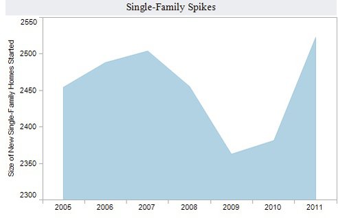

More and bigger is what they want
According to several reports, after a brief period where home sizes remained stable or reduced, new single-family home sizes are back on the rise.
I had hoped that the industry and consumers had learned some sort of lesson from the last real estate crash, but it appears that they haven’t. People still want big homes, and with mortgage rates at historic lows and energy prices lower due to expanded natural gas resources, there may be little to stop this trend.
