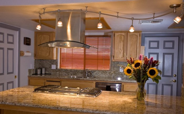

What’s the payback on the granite countertops in the kitchen? What’s the payback on those hardwood floors? And, most important of all, how long will it take for that beer-launching refrigerator to pay for itself? (You’ll have to watch the video to find Dave Letterman’s answer to that last question.)
The point here is that payback measures only cost effectiveness, but if the investment has other benefits as well, payback is an incomplete picture of the value of your investment. When you invest in a high performance home, energy efficiency is only one of the benefits. You also get comfort, healthfulness, and durability.

To borrow the article reference about granite tops: when someone buys granite counter tops for the kitchen and the bathrooms for $20k but then skimps out on insulating the home beyond code minimum, what is the ROI for those granite tops? Yet, for the next 50+ years the home will be an energy hog operating at code minimum (usually 2006 codes).
I was discussing with someone about getting better windows on their new home build. They would argue that they don't want to spend the money on energy efficient windows, as it does not add value to their home when it comes to selling it later on. That is the mindset of some people. What surprised the home builder was that when he priced out his double pane U-Value 0.35 big box store windows, the homeowner could get triple pane U-Value 0.17 windows like Intus uPVC for a few dollars more than what he was going to pay for the double pane windows. In addition the sliders and double hung windows he was going to get leaked a lot of air. While the European triple pane tilt & turn operable get < 0.03 cfm/ft². The sad part is that when the builder tells them that adding better windows or adding more attic insulation for $1,000 is not worth it because the "payback" is 30 years, this feeds into the flawed payback concept.
Response to Peter L
While I am on your side, I wouldn't want to give people the impression there is no payback for granite countertops. If the homeowner goes with formica instead of granite, there is probably a negative effect on their resale value. Countertops don't have an "operational ROI" (if there is such a term) like energy efficient products do.
Said another way, countertops can have 1 ROI (resale). Energy efficiency has 2 ROIs (lower operating costs and resale).
