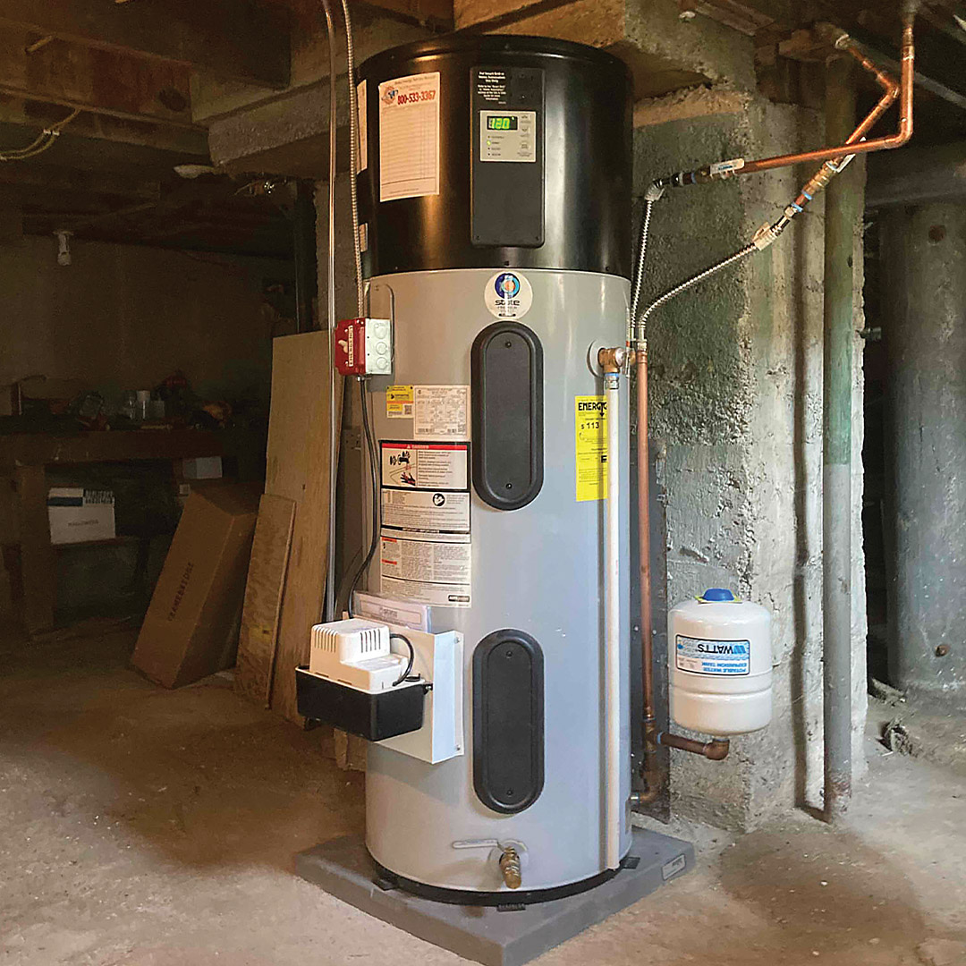

How a heat pump water heater saves energy
Currently, water heaters of all types account for about 18 percent of U.S. households’ energy consumption—more than cooking and refrigeration combined. Many homes are equipped with electric resistance heaters that needlessly draw excessive amounts of energy from the national power grid and contribute to high utility bills. The impact of gas and propane water heaters, now operating in half of all U.S. homes, is even worse: They burn fossil fuels, releasing greenhouse gases and dangerous toxins like nitrogen oxides, which have been linked to numerous respiratory diseases.
In contrast to conventional gas-fired heaters, which generate heat from pollution-spewing combustion, or electric heaters, which use the same type of inefficient mechanism found in a toaster, HPWHs use an energy-efficient compressor that gathers heat from the atmosphere and concentrates it in a water storage tank. The result: savings for the average four-person U.S. household of $550 a year on electricity bills, or more than $5600 over the life of a typical HPWH, according to the Energy Star consumer website. (Actual savings will vary, depending on home size, location, and the municipal or private utility that supplies electricity to your home.)
Residential energy efficiency is an important tool in addressing climate change, and embracing greener technologies like this one is a meaningful contribution for the homeowner looking to help propel a low-carbon economy forward.
