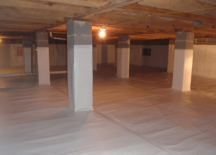

Clean and dry
This crawl space has been sealed to prevent air leaks and energy losses. Polyethylene sheeting on the floor is an effective moisture barrier.
Image Credit: GBA
Morgan Martin’s dilemma is what to do about the crawl space beneath the house, identified in a recent energy audit as a source of air leaks and energy loss.
The joist bays above the crawl space have been insulated with fiberglass batts, but the subflooring has not been air-sealed. A local green building company recommends removing the batts and taping and caulking all the gaps in the floor (that is, the crawl space ceiling). Once that’s accomplished, the builder lists three options:

  1. PWiyZXRHbr | | #1
    Crawl space venting & insulation details
    The "CleanSpace" system of crawl space encapsulation, developed by Connecticut-based Basement Systems, has achieved an impressive track record for turning damp, pest-infested, energy inefficient crawl spaces into clean, conditionted, energy-efficient areas. This system is designed to handle worst-case crawl space scenarios, with a perimter drain and sump pump system to remove water, a super-durable plastic moisture barrier to seal the dirt floor, and both spray and rigid foam to insulate and air-seal the foundation walls. There's even a gasketed, PVC cover that completely seals crawl space vents and doors. It's worth checking out if you want to see a well-designed, state-of-the-art system.
