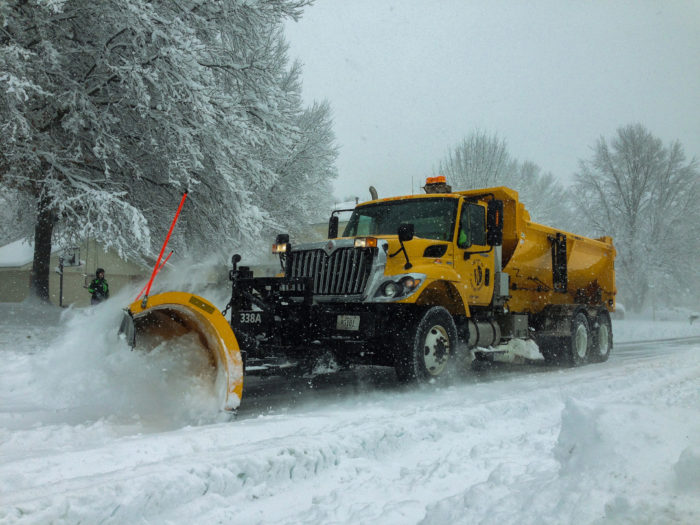

If you live — and drive — in a northern or mountainous climate, you’ve seen highway trucks spreading loads of rock salt on snowy highways to melt the ice. But where does the salt go?
