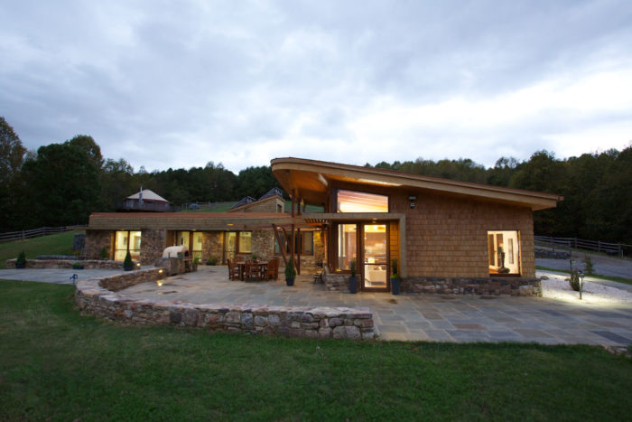

![](http://images.greenbuildingadvisor.com/app/uploads/2018/07/24204340/08-131010_Earthship.Farmstead_0083-main-700x467.jpg)
Image Credit: Brett Winter-Lemon
Image Credit: Brett Winter-Lemon The view to the east. The stone terrace is nearly as big as the house itself and takes in views of the Virginia countryside. The owners raise water buffalo on the property.

A house built into the side of a Virginia hillside on a working water buffalo farm has been named the outstanding single-family home of the year in the 2013 LEED for Homes Awards by the U.S. Green Building Council.
“Earthship Farmstead” in the western Virginia town of Stuart, was one of seven projects recognized last month by the U.S. Green Building Council. It was designed by Kaplan Thompson Architects of Portland, Maine. (Jesse Thompson, the lead architect on the project, is partnered at the firm with Phil Kaplan of GBA’s Green Architects’ Lounge.) The house was built by Structures Design/Build.
The 3,600-sq. ft. house, which was completed in 2012, includes three bedrooms and an outside terrace nearly as big as the house itself. It meets both the Passivhaus and LEED Platinum standards, the USGBC says. “Earthship Farmstead,” Thompson said, is a reference to the New Mexico Earthships of Michael Reynolds.
According to an article about the house appearing in the Wall Street Journal‘s “Mansion” section on May 9, the house was built for David and Liisa Wallace, an English couple who had wanted to leave the Britain and found the 104-acre parcel in rural Patrick County with the help of Ms. Wallace’s brother.
The Wallaces wanted a house that disappeared into the landscape, and when viewed from atop its sod roof that’s more ore less what they got. But Thompson said building this insulated, underground structure capable of meeting the Passivhaus standard was very complex. “It got complicated,” he said.
