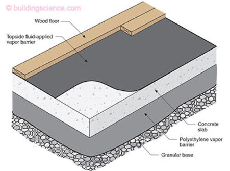

That said, the question for this Spotlight is: Why is it okay to install a vapor retarder over a basement slab, but not on…
I see that I didn't pay close enough attention to the specific question regarding slabs, of placing a vapor retarder OVER a porous slab. In his article (https://www.greenbuildingadvisor.com/article/vapor-retarders-for-basements-and-crawlspaces), Martin says you can install poly over the slab, but he also says you need foam insulation and a plywood or OSB subfloor over it. I fully agree; poly alone would likely result in condensation, but the foam prevents condensation. Foam needs to be covered with a fire-resistant layer and it also needs to be something you can walk on, which I'm sure is why he recommends plywood or OSB. Andy Engel's classic article explains the finer points: https://www.finehomebuilding.com/2005/03/01/the-no-mold-finished-basement.
