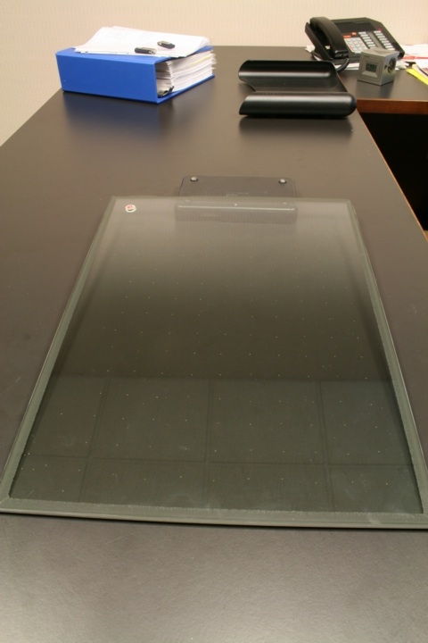

The same principle can be used in a window if the space between two layers of glass is evacuated. That’s what Michigan-based Guardian Industries, one of the world’s largest glass manufacturers, is doing with its Vacuum-Insulated Glass (VIG). While not yet on the market, Guardian has had this product under development for a number of years–and a few foreign companies have VIG windows on the market already.
Guardian’s product separates two layers of glass by a very thin space–just 250 microns or a quarter-millimeter–using tiny, almost invisible “pillars” to keep the panes of glass from sucking together and touching. Instead of standard clear glass, Guardian uses an advanced low-e glass as one of the layers. The use of low-e glass is critically important, because it slows down the third form of heat transfer through windows: radiation. Radiant heat flow can occur without air, so this becomes the primary means of heat loss through a VIG window.
The performance of Guardian’s VIG glazing is indeed very good. Scott Thomsen, vice president and chief technology officer at Guardian Industries, told me that their VIG will achieve at least R-10 (center-of-glass) insulation, with potential for R-12. The use of the latest-generation low-e coating is crucial to this level of performance. If the company were using the best low-e from five years ago (which was made by sandwiching two low-e coatings together–low-e2), the performance would only be about R-7 center-of-glass. The newest low-e sandwiches three layers together (low-e3), significantly increasing the insulating performance of the VIG.
The company has been aiming for performance comparable to a triple-glazed window with two low-e coatings and krypton gas fill—the sort of window I wrote about last week. Thomsen says they will achieve this performance at about the cost of a triple-glazed window with argon gas fill (argon is a lot cheaper than krypton) and with a VIG glazing unit just over a quarter-inch thick, rather than over an inch for triple glazing.
Even though the vacuum needed in a VIG window is “softer” than that used in a Thermos bottle (10-4 torr instead of 10-6 torr in the parlance of vacuum physics, or one-hundredth as strong a vacuum), the edge seal is still extremely important. If the vacuum seal is lost, that R-10 to R-12 window would probably end up not much better than R-2.
According to Thomsen, the edge seal is a “hermetic, glass-to-glass bond using a non-organic, lead-free solder glass frit material.” In other words, it’s not a glue or traditional sealant that’s commonly used in sealed insulated-glass units. He tells me that the “frit” is a “modified version of a proven material that has been around for several decades” and is used in both flat-screen and older-style, picture-tube televisions.
One drawback to a VIG window is that the tiny pillars that keep the panes of glass separated slightly affect the optical clarity of the windows. When viewed at a low angle, these tiny beads are visible to some people. Guardian has found in focus groups that about 50% of people were able to see them. It’s unclear how much of an issue this will be in windows used for views; it shouldn’t make any difference in windows above the vision plane or in skylights.
