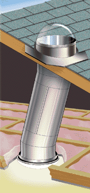

Tubular skylights have three components: a round, domed plastic skylight that mounts on the roof; an 8- to 22-inch-diameter cylindrical metal tube with a highly reflective interior surface that is usually less that 12 feet long, but in some cases may be over 20 feet; and a diffuser that mounts on the ceiling. Sunlight shines through the skylight dome and bounces its way downward through the reflective tube to the diffuser, which delivers the light below. For cold climates, some manufacturers offer an additional layer of glazing in the tube or diffuser to reduce heat loss back up through the tubular skylight.
While a standard skylight requires structural modifications to carry roof loads as well as a large, insulated light-well to bring the light into the living space, a tubular skylight is thin enough that it can fit between roof rafters or trusses and ceiling joists. The installation is much easier and less expensive. Most tubular skylights come with very good flashing kits to make the roof penetration weathertight–though the challenges of any roof penetration shouldn’t be underestimated, and an experienced contractor should be used.
Tubular skylights reduce daytime electricity use for lighting. Daylight is only provided only during the daytime, of course, so savings will only occur in applications where spaces are used during the daytime. It’s a great option for home offices, home daycare spaces, and homes for retired seniors—but not as good when homeowners are gone all day.
Tubular skylights are most effective in providing illumination to upper-floor or single-story houses where the ceiling is less than 10 or 12 feet from the roof. Installations in which tubular skylights extend through a second storey to provide light to a first-floor space are less common–but can be done.
The key to effective operation is the highly reflective interior surface. These aluminized surfaces often reflect more than 95% of the light striking them. But because the reflectivity is less than 100%, there are light losses with increasing length of these skylights. A tubular skylight delivering daylight through 20 feet of reflective tube will deliver significantly less light that one with just six feet of tubing. Keep that in mind when planning installations.

Heat loss with tubular skylights
Are there data on the thermal performance of tubular skylights ?
Interesting question Interested
I have 2 in my home and I like the daylight provided..
in my case they pass thru a conditioned attic.
I still have to wonder about the airtightness and u-value at the top, the bottom and the heat transfer along the shaft.
In the case case of a not conditioned attic .. I would think that the heat transfer along the shaft could be considerable.

When we run them through an unconditioned attic, I run about the first 3 feet or so in a Sonotube (concrete form) that is 2" bigger than the sun tube. For instance, if we have a 10" sun tube, we use a 12" Sonotube. I air seal the bottom of the sun tube at the ceiling , then fill the remainder of the sonotube/suntube space with cellulose (I'm not sure if this step is necessary, but it also protects the flimsy sun tubes). I haven't had any condensation problems with this. The diffusers seem to air seal pretty well against the ceiling. The blower door/infrared doesn't show leaking..
Less uninsulated volume than a tradittional skylight, but it's still a 10" uninsulated hole in the ceiling.

Solatubes have a .43 U-factor which qualifies it as an Energy Star rated product. If you get the E-choice model it bumps it down to a .30 U-factor and qualifies for a 30% federal Tax Credit. The tax credit apply's to the product cost and not the installation.

Good questions. One manufacturer offers a tubular skylights that achieves the "30-30" threshold for windows to satisfy the 30% federal tax credit. That means a U-factor below 0.30 and a solar heat gain coefficient below 0.30--which I suggest may not make sense (installing a product with such a low SHGC). I'd love to see good test results that would answer your questions. As for light output compared with CFL or LED lighting, the lumen output from tubular skylights is typically far higher than that from most CFL or LED fixtures, so a simple one-for-one comparison may not be relevant.

Rated lumen output from a tube skylight is seldom the critical factor. The diffuse light from these fixtures may be sufficient for daylight walkthrough of an interior hallway (though leaving the adjacent room doors open may be just as effective) but many would find it inadequate for personal grooming in an otherwise unlit bathroom. Mike had it right: "equivalent to a low end florescent fixture": I would add 'an often poorly located low end fluorescent fixture'. Good lighting design requires more than horsepower (lumens) and if you want your tube light to be useful for more than just finding the light switch you will have to give more thought to placement than is generally shown.
And if environmental concerns mean anything to you, please bear in mind that you are putting an R5 hole in an R38+ ceiling, and the ongoing energy costs of the installation (both by transmission and air leakage) will be incurred 24/7, while the energy benefit, especially if the space is used only sporadically, may be marginal or nonexistent. Tax credits, attractive as they may be, are not a reliable guide to environmental performance. I believe that most homeowners could find far better use for the $300-$500 cost of a light tube.
