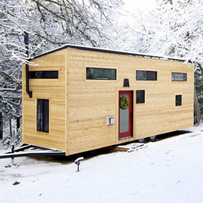

This 317-square-foot home in Oregon belongs to Andrew and Gabrielle Morrison, advocates for wider acceptance of tiny homes who were instrumental in passage of a new standard for houses less than 400 square feet.

    The appeal of building on a trailer is to avoid these costs - or more accurately to offload them onto someone else. You can't just wander down a country lane, find a picturesque spot and settle down. You need to find somewhere that already has the necessary services. The picture accompanying this article illustrates this perfectly. It would be instructive to know how the occupants handle services in their spot nestled under that tree or how during their tenure there they are contributing taxes to the community that is supporting them.
