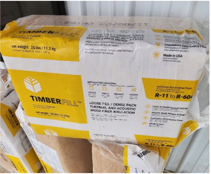

Loose-fill wood fiber insulation is one of three products TimberHP manufactures in Madison, Maine. Photo: Randy Williams
