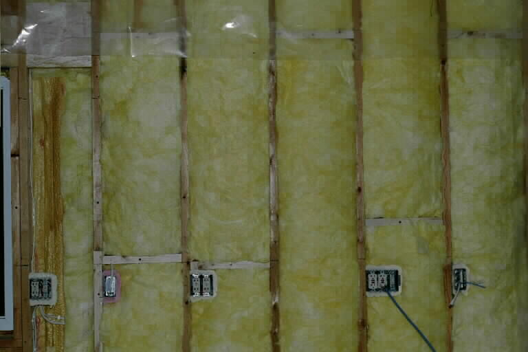

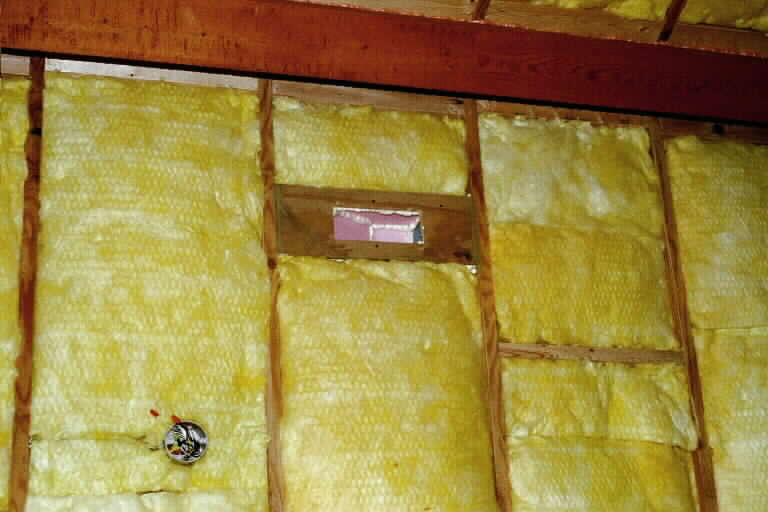

Question for Martin or John. A piece of R-19 fiberglass batt, stapled to a knee wall, now has a thickness of 1/4" at the point of stapling. Is it still R-19 at the point of stapling? This is where I think our discussion diverged earlier. My understanding of fibrous insulation is that the R value is almost enitely based on the trapped air in the material. Once crushed -- by stapling or being jammed into a tight space, the air in the material is reduced. Presumably the resistance to heat transfer is reduced with less air, hence the R value is reduced, right? Physical properties of most materials change when the material condition is altered - crushed, soaked in water, heated, cooled, etc. I assume that fiberglass batts have the same sorts of limitations as other materials.
details.

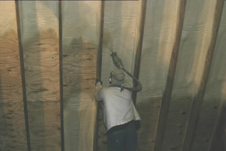

Our foam contractor applied 2" and allowed it to cure for at least one full day before applying the final 2".
We have a heat recovery air exchanger.

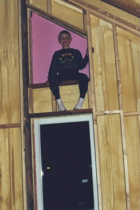

Foam adds strength, it can easily double the racking strength of a wall.
Hey Robert Smith, fiberglass
Hey Robert Smith, fiberglass is best when used as a filtering material. Ha,ha! There can be actual air circulation in wall/ceiling bays insulated with fiberglass because figerglass cannot not stop air movement. Closed cell foam can stop air movement dead. That's a huge difference, and why fiberglass works much better when used with a closed cell insluation like poly foam.

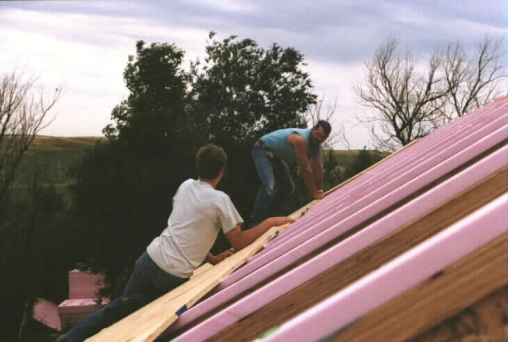

We used double 2x4 wall construction with one inch between the walls. 2" foam was sprayed on the outside wall encapsulating the studs before the inside wall was built. The resulting open cavities were filled with fiberglass;
http://www.wrtc.com/rvsrchjl/house/monkey.jpg
http://www.wrtc.com/rvsrchjl/house/staggeredstuds.jpg
Ceiling;
http://www.wrtc.com/rvsrchjl/house/jfoam.jpg
http://www.wrtc.com/rvsrchjl/house/insul2.jpg
http://www.wrtc.com/rvsrchjl/house/ceilinginsulation.jpg
