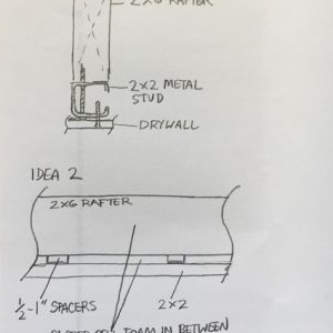

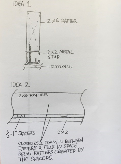

Roof
Among the best ways to limit thermal bridging through cathedral-ceiling rafters is to insulate the underside of the ceiling with rigid, foil-faced polyisocyanurate. If carefully taped, the polyiso makes a decent air and vapor barrier, and if it’s held in place by 1×3 or 1×4 strapping, an airspace is created that adds to the R-value of the roof assembly.
