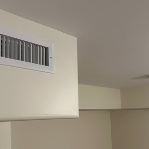

HVAC design is more than a load calculation. Even proper sizing isn't enough. The photo here should clue you in to what really matters, though.

As you can see in this schematic, a duct design includes a lot of information. It also depends on a lot of variables.
Many people seem to think HVAC design means you get a load calculation (Manual J in the ACCA protocols) so you know what size system to put in. Hey, that’s a great start. It’s way better than just using a rule of thumb or Manual E (for eyeball).
