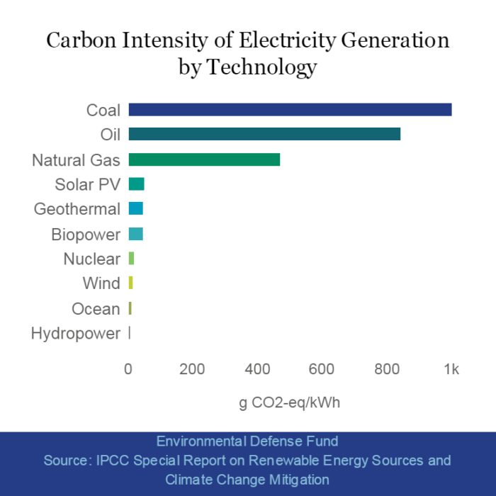

In addition to the types of pollution described above, fossil-fuel power plants also release greenhouse gases like carbon dioxide into the atmosphere – the main culprit of climate change. The carbon intensity of electricity generation varies significantly by fuel and technology, with coal and oil generation producing the most carbon and certain renewable energy, like solar and wind, producing none. However, as mentioned earlier, these renewables do produce carbon in upstream operations. The graph (above) shows the total lifecycle carbon emissions for each technology, including upstream and downstream emissions.

The IPCC bar graph needs better explanation
For natural gas to have the same carbon footprint equivalent relative to coal in that bar graph it would have to either be operating at about the same thermal efficiency as coal plants or there is a presumed and fairly substantial methane release per kwh. The average sub-critical coal plant runs in the low 30s percent efficiency, supercritical coal in the 40s. Combined cycle gas plants (dominant, in the US grid) operate in the 50s bumping on 60% thermal efficiency when load & operating conditions are optimal. The carbon-equivalent footprint of gas plants in the US is probably between half an 2/3 that indicated unless high methane release during the fuel extraction is presumed.
That does little to blunt the argument that simply changing coal & oil fired generation over to natural gas simply isn't going to be enough to meet greenhouse gas targets, however.

Of course the methane counts...
...which is prompted the speculation "...unless high methane release during the fuel extraction is presumed."
The bar graph alone without the underlying assumptions can be misleading. Lot's of things "...could be part of the calculation...", but I'd personally like at least a somewhat fuller description of how those relative numbers were developed, without having to dig into the footnotes of the IPCC Special Report on Renewable Energy Sources and Climate Change Mitigation. It's a tidy little graphic, with potentially big error bars on the numbers.
