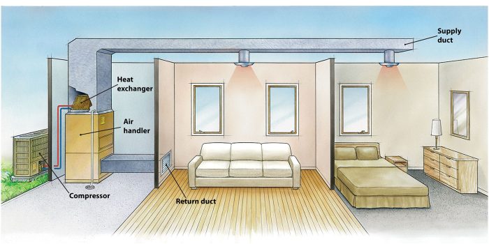

Oversized furnaces, heat pumps, and air conditioners are the norm in most American homes. That’s a problem, since oversized equipment often provides lower levels of comfort and costs more than right-sized equipment.
Designing and installing a forced-air heating and cooling system is a multi-step process that should include heat-loss calculations, heat-gain calculations, equipment sizing, and duct system design. In a typical residential installation, however, some of these steps are performed sloppily or entirely omitted.
The purpose of a heat-loss calculation is to determine the design heating load, which is used to select the heating equipment needed during worst-case conditions: that is, during a very cold day in winter with no solar gain through the windows. Heat-gain calculations are used to determine the design cooling load, which is used to size the home’s air conditioner. These heat-gain calculations also assume worst-case conditions: a very hot day in summer with maximum solar gain through the windows.
