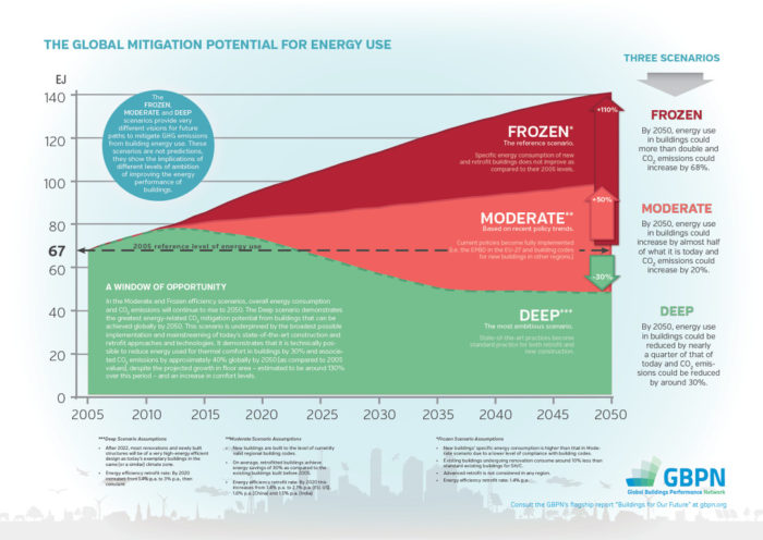

Alan Gibson (my GO Logic colleague) and I just returned from the 18th annual International Passive House Conference in Aachen, Germany. This incredible three-day conference featured some of the superstars in the Passivhaus community as well as influential European policy makers, including Dr. Wolfgang Feist, founder of the Passivhaus Institut.
We witnessed a watershed moment in the adoption of the Passivhaus standard in European policy, and saw solid evidence of widescale, successful implementation of all types of Passivhaus projects across the globe. And I am happy to report that North America was well-represented. Our GO Logic presentation was one of several demonstrating Passivhaus market viability in North America.
Higher renovation standards yield increased energy savings
Of the many inspiring, interesting, and in some cases very geeky perspectives that we were exposed to, there is one that has really stuck in my mind that needs to be better understood in order for anyone — be they policy makers, lenders, or homeowners — to make sound decisions regarding investment in reduced building energy consumption. Dr. Diana Ãœrge-Vorsatz, director of the Center for Climate Change and Sustainable Energy Policies at Central European University, presented this new perspective using the catchphrase “lock in.”
When you look at the long-term impact of different levels of energy-efficiency in buildings across a 50-year span, taking an incremental approach to renovations — achieving, say, a 40% improvement in building performance — is actually a very poor strategy, Dr. Ãœrge-Vorsatz explained, as compared to waiting several years until a proper Passivhaus-level building shell can be implemented. How could that be?
Well, across a 50-year period, on a macro scale, a moderate, LEED-Gold-level energy retrofit will hold the greenhouse gas emissions from building energy use to only a 46% increase from today’s levels of CO2 in the atmosphere. This is not such a bad result. Consider what would happen if we do nothing to improve energy efficiency by the time the global population is 9 billion people. Building energy use will increase by 110%, with CO2 emissions increasing by 68%. Draw your own conclusions about what will happen next.
Meanwhile, a Passivhaus-level renovation approach will actually reduce energy use of buildings from today by 34%. That means the difference between doing a Passivhaus renovation over standard, incremental improvements is actually an 80% difference in CO2 levels over 50 years! The graph at the top of the page illustrates this concept.

In Dr. Ãœrge-Vorsatz’s words, the “lock in” effect is acknowledging that most buildings that undergo a moderately efficient renovation are not likely to be renovated again for another 50 years, given the financial strain on owners to recover the original renovation investment cost. In other words, you will not re-replace the windows in 10 years, even if you understand window specifications better then than you do now. Your replacement windows have “locked in” a moderate level of efficiency for the long term, and that decision will result in 80% more CO2 emissions than a Passivhaus renovation would have.
Conventional wisdom is that incrementally increasing the performance of buildings is the best approach. That concept needs to be revisited. “Locking in” with moderate improvements in energy performance has a massive negative outcome over the life of a building renovation — which is the margin we require at this stage to combat global warming. So if Passivhaus-level efficiency appears out of reach when building new or renovating — given that the policy, products, and financing required to make it happen are not yet in place — it is worth considering waiting a few years until they are available, for your own financial interest and for the health of the planet.
For more information on the “lock-in” concept, please visit the Global Buildings Performance Network.

My understanding is that "lock-in" graph shows energy use for all buildings - commercial and residential. Most commercial buildings are categorically different from residential buildings, with most loads coming from ventilation requirements, lighting, and plug loads, and their schedules. There are sometimes non-obvious trade-offs. For instance, infiltration and and lower thermal resistance may provide substantial cooling in commercial buildings in colder climates with high plug loads, and this cooling may be as important as the benefit of reducing heating demand in the colder months. Of course, as plug and lighting load goes down, wall and window thermal resistance becomes more important. Infiltration also matters for humidity contributions, and is significant for high-traffic buildings (retail), or tall buildings.
I expect that reducing plug, lighting, and ventilation requirements will dictate the energy savings in commercial buildings over the coming years. It'll be the lower solar-heat gain windows and sensible window-to-wall ratios in new construction in South China and India that will dictate building energy demand globally, not so much the relative difference between triple-pane and double-pane in the heating climates of Europe or North America (though this is still important, and should be encouraged).

The carbon content of heating/cooling energy isn't constant over time OR location. Assigning hard CO2 emissions levels to a building's energy use simply has no single-number hard basis, and can vary by more than an order of magnitude. A code-min house on a hydro & wind & solar powered grid (like much of Quebec or Washington state) heating a building leveraged by heat pumps can be lower-carb over then next 50 years than a PassivHaus starting out with the present-day German grid.
And without a crystal ball or a completely inflexible decades long power development plan, how do they average the carbon content of power used at the PassivHaus on the German grid (or any grid) over the next 50 years?
The implied precision in the numbers presented are quite dubious when delivered without the underlying assumptions.

What I want to know is, what scenarios were played out in Dr. Ürge-Vorsatz's crystal ball that led to such seemingly fixed CO2 numbers for total? What is the basis for assertions such as
"Well, across a 50-year period, on a macro scale, a moderate, LEED-Gold-level energy retrofit will hold the greenhouse gas emissions from building energy use to only a 46% increase from today’s levels of CO2 in the atmosphere. " ???
That 46% number seems like a real number- not a rounding off to 45% or 50%, but there is no hint of just how big the estimated error bars on that are. Could it really be a 60% increase, or possibly a 10% DECREASE? Show me the base assumptions, and the math!
It's simply not a number that stands credibly on it's own- it needs clarification, beginning with the underlying assumptions about the carbon content of the energy used, and how carbon emissions from non-building sources tracking, etc. Whatever the assumptions are, at least some of them are guaranteed to be wrong, and wrong in ways that effect the outcome. As a number seemingly pulled out of the ether, without context it's a useless & not particularly credible number to work from. None of this operates in a vacuum.
