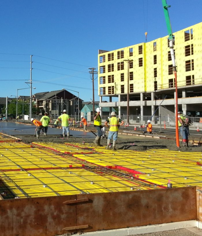

The three-story wood-framed building sits on a slab-on-grade foundation (see Image #1, above). Typical exterior walls have 2×10 framing with blown-in fiberglass cavity insulation and 1 1/2-inch-thick rigid mineral wool exterior insulation (see Image #7, below). Mineral wool was chosen due to its permeability and capacity to facilitate drying to the exterior.
At the exterior walls, the plywood sheathing (with taped seams) serves as the primary air barrier. Plastic housewrap installed over the sheathing serves as the water-resistive barrier. A smart vapor barrier is located on the interior of the wall framing. This is a polyamide membrane with a variable permeance rating to allow the wall to dry to the interior.
The ground floor slab sits on a 4-inch layer of EPS insulation, which also wraps around and under the perimeter and interior footings. Type II EPS is used under the slab and at the sides of the footings; however, Type IX EPS is used under the footings for its higher bearing capacity.

Construction has started
In 2011, REACH selected Walsh Construction Company as the general contractor for the project. We’ve been at the table with REACH and the design team from project inception, working together in a highly collaborative effort to help put the project together. Construction began in June 2014, and a great deal has happened at the site since then.
The project is scheduled for completion in May 2015. Over the next six months, we plan to share stories of the construction, including successes as well as some of the challenges we’ve encountered along the way.
