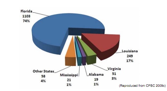

The number and percentage of drywall complaints received as of September 2009.
Image Credit: U.S. Consumer Product Safety Commission
By the time the U.S. Consumer Product Safety Commission and its team of consultants and testers had completed their investigation of problem drywall imported from China during the building boom, the agency had heard complaints about the drywall from 3,905 homeowners in 42 states, the District of Columbia, American Samoa, and Puerto Rico.
