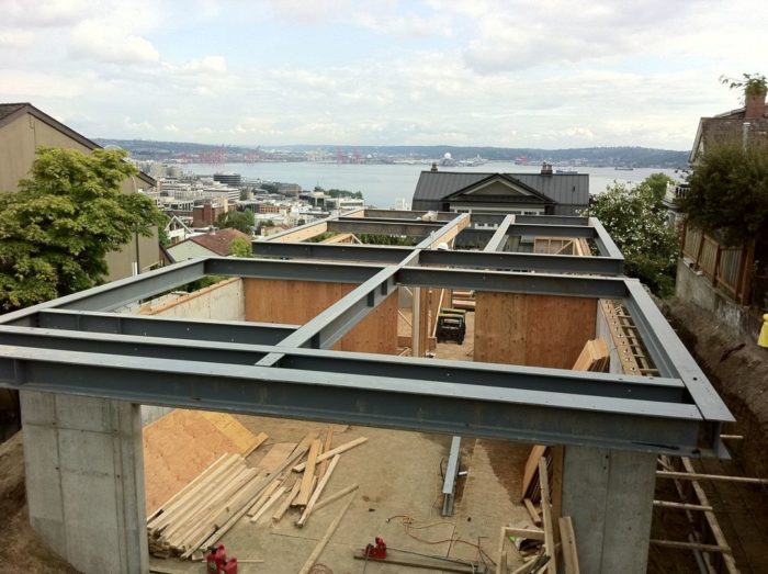

Steel I-beams that support cantilevered floors in this modernist Seattle home are proving difficult to insulate effectively.
Brandon M. is building a three-story house in Seattle whose design includes cantilevers on the second and third floors. The designer has specified steel I-beams to provide the structural support in this modernist design, and this is what’s giving Brandon pause for thought.
Although Seattle’s climate isn’t exactly arctic, it gets cold enough. The beams will not be exposed to the elements, but are located close to the outside of the building, and Brandon fears the steel might wick in cold temperatures. That could lead to condensation inside the building that eventually may rot the wood framing joined to the steel.
As originally planned, the bottom flanges of the I-beams would get a scant 1/2 in. (R-2.5) of insulation. Would that be enough to head off the problems he envisions? Brandon asks in this Q&A post. Further, are there products designed for this application? And, does anyone have suggestions about the details?
Brandon’s building dilemma is the topic of this week’s Q&A Spotlight.
‘Back to the drawing board’
The design makes GBA senior editor Martin Holladay cringe.
“I would talk to your architect about changing the design,” he says. “You don’t want steel beam cantilevers penetrating your thermal envelope. Back to the drawing board.”
Holladay and others react strongly to Brandon’s original description of the project because it suggests the beams would actually penetrate the building envelope.
This kind of design, writes Jesse Thompson, are “classic leak points on decks and overhangs in a marine climate, and very tricky to seal where they enter the building. They can wick long distances if they get a chance.”
Brandon clarifies: “The steel beams are fully encased by…

    steel in and of itself isn't
    steel in and of itself isn't inherently bad - in this case it's just not used in a thermally efficient manner. i can point to a multitude of steel buildings that are better at taking this into account. and there are applications for cantilevering steel through the envelope without compromising the envelope, as i mentioned in the original post.
    a bigger issue is when renowned architects tell their employees (or even worse, students) that as long as the steel is 1/2" in thickness, it doesn't cause any thermal bridging...

    In Seattle?
    While the energy penalty posed by the thermal bridging is an obvious concern, condensation is not something I would worry about...especially at this point in construction. No, it's not ideal or even good practice but it's not something I would panic about.
    I looked up the average lows for Dec. and Jan. in Seattle: 36F. It just doesn't get cold enough for long enough to produce enough condensate to cause a problem. By problem I mean rot, insulation dampening, water staining of interior finishes, etc. Likewise, it doesn't get that hot in the summer, so people running air conditioning in the summer aren't going to get the problem in reverse either.
    I work primarily in Minnesota. I've seen some pretty spectacular condensation problems. One building I renovated was a manufacturing use with high humidity required for some processes. The building was old and had a poorly insulated metal roof deck. When it got below 10 degrees or so it basically rained indoors. Translate that to a Seattle house and as long as the residents don't go hog wild with humidifiers in the winter they should be fine. Then again, we're talking about Seattle where the heating season is the same as the rainy season so I'm guessing no one ever needs extra humidity.
