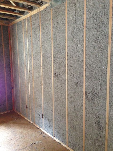

If you’re building a house and want to have a really good building enclosure, you need it to be airtight, handle moisture properly, and have a good amount of insulation. Ideally, you’d also consider the effects of solar radiation on the home, but for now let’s just focus on the insulation. What exactly is “a good amount” anyway?
Insulation is like alcohol
If you’re a practical person, I’m sure you realize that life has a tendency to make you aware of certain limits. After the first few drinks in an evening, for example, further libations have less and less of an effect. Well, less and less of a positive effect anyway. Unfortunately, diminishing faculties obscure the diminishing returns, and you wake up the next day wondering how your head got in that vise. (Not that I know anything about that. I take all things in moderation, including moderation.)
The same is true with insulation. Below we’ll take a look at what happens as you keep increasing the R-value in a wall. If you just want to understand the concept of diminishing returns, you can skip ahead to the text below the graph. For the building science geeks out there, though, I need to tell how I generated the numbers for the graphs.
