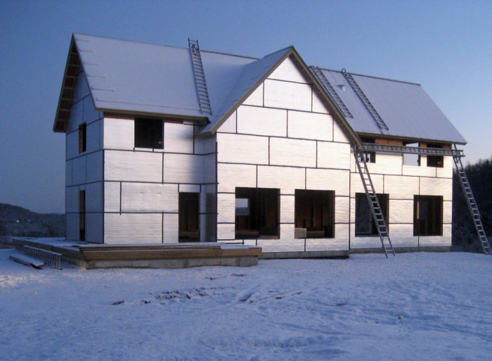

A layer of rigid foam insulation reduces thermal bridging in the exterior walls of this Vermont home designed by architect David Pill.

Over the last few years, New England and other cold regions of the U.S. have seen a growth in the use of rigid insulation on the exterior of buildings. This use of exterior rigid foam first started appearing in commercial buildings and was driven primarily by the International building codes which required steel-stud buildings to place rigid foam on the exterior of the structure.
Why? Steel studs are great thermal conductors, and these thermal bridges were conducting the heat from the inside to the outside in the winter and the reverse in the summer. This was making the insulation in the cavities between the studs practically useless and causing the R-value of the walls to be 50% lower than many people assumed. So builders decided to skip the insulation in the cavity (unless needed for sound suppression) and put all the insulation on the outside.
This insulation method is now gradually entering the residential marketplace, driven by the newer International Residential Codes which beginning in 2009 started recommending (in colder climate zones) a 2×4 wall with R-13 in the cavity and R-5 on the exterior as an alternative to a 2×6 wall with R-20 insulation in the cavity.
Where less actually is more
The thinner wall actually is a better insulated wall than the thicker 2×6 wall. Huh? In what modern math is 13 plus 5 more than 20?
Perhaps not math — but basic building science! If you build a wood-stud wall framed at 16 inches on center, you end up with 25-30 percent of that wall being wood, not insulation. That wood acts as a conductor (not as bad as steels studs, though) which channels the heat out of the building. This can reduce your insulative value by 15-20 percent.
So, by putting rigid insulation over the sheathing and studs, you reduce this bridging effect (thermal bridging).
Consider this: It’s been calculated that a 2×4 wall with R-13 insulation in the cavity actually has a whole-wall R-value of only R-11, and a 2×6 wall with R-20 insulation is actually performing at R-15.67.
