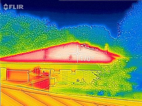

![](http://images.greenbuildingadvisor.com/app/uploads/2018/07/24225659/hot-dark-roof-infrared-image-main.jpg)
Image Credit: Cameron Taylor
Image Credit: Cameron Taylor When looking at white vs. black shingles, the more reflective white ones win. Their peak temperature is about 20°F cooler on a hot day.
Image Credit: FSEC FSEC studied the same house with dark tile roofing and then changed to white. Attic temperatures dropped significantly.
Image Credit: FSEC Data from the house that first had dark gray tile roofing that was changed to white. Notice the sharp drop in attic temperatures.
Image Credit: FSEC Attic temperatures for different roof types are shown in this graph. The most reflective roofing drops the attic temperatures more than 20°F.
Image Credit: FSEC

So, sometimes people do have good reasons for wanting to keep an attic cool. What are the options? Powered attic ventilators seem to be the one a lot of people want. It’s relatively inexpensive. It’s quick to install. And it does lower attic temperatures. But I know of two other methods that both are better than PAVs. One is a radiant barrier. The other is a reflective roof. And one of those is better than the other. (Of course, there’s a fourth option: You could install an air conditioner in the attic, but that’s the stuff of April Fool’s Day jokes.)
The research on reflective roofs
There’s been some good work done on how the type of roofing affects the attic temperatures and cooling loads in the house. The Florida Solar Energy Center (FSEC) has done quite a bit of work in this area and even built a test building called the Flexible Roof Facility to study different types of roof and attic assemblies. They’ve also done research on a number of real homes in Florida.
One of the earliest studies they did was to look at the difference between black shingles and white shingles. The first graph below shows the results, and you can see that it’s about what you might expect. White shingles reflect more of the incident solar radiation and stay cooler. They don’t show the attic temperatures here, but if the shingles are cooler, the attic is cooler. (You can read more about this in FSEC’s literature review of attic ventilation. The graph is from page 30.)
In another study, they changed the color of a home’s tile roofing from dark grey to white. (See Image #3,. below.) Here they did measure the attic temperatures, and you can see them in the next graph (Image #4). The white roof lowered the attic temperature by about 20 F°. (These images came from a presentation Danny Parker gave on FSEC’s cool roof research.)
The third graph shows attic temperatures from the middle of the attic for several different types of roofing as well as a sealed attic. In this case, the most reflective roofing material (ivory IR selective metal tile) is 23.4 F° cooler than attic covered with dark shingles. (Read more about this in Danny Parker’s 2004 Home Energy magazine article, Improving Attic Thermal Performance.)

My friend Cameron Taylor has done a less formal study on his own home in Fort Worth, Texas. The design temperature there is 98° F, and they’ve been experiencing quite a few days where it gets above 100° F in recent years. He replaced his roof with a reflective metal roof (shown below) and wrote this to me in an email:
My experience with my own reflective roof is going on three years, now. Each summer has been consistent with air temperatures in attic tracking below outdoor ambient until mid afternoon, where it then tracks with outdoor ambient.

As you might expect, it’s not hard to show that reflective materials keep things cooler. When solar radiation hits a surface, three things can happen. It can be reflected; it can be absorbed; or it can be transmitted. The part of the solar spectrum that heats things up doesn’t get transmitted through roofs, so the incident solar radiation is either reflected or absorbed there. The more of it you can reflect, the less gets absorbed. Reflective roofing attacks the problem right there where it starts.
Once the solar radiation is absorbed, some of the heat still gets ejected to the outside but much of it conducts downward through the roofing materials and roof deck. There it radiates down into the attic, heating up the insulation, the framing, the ductwork, and the boxes of Christmas tree ornaments. A radiant barrier can help by reducing the amount of that heat that radiates downward. But still, the heat is already in the roof. Radiant barriers are fine, but why not stop the heat on the side of the roof where it first enters?
Powered attic ventilators are the worst way to try to keep your attic cool. They’ve been well-discussed here and other places, but briefly they’re not cost-effective, don’t deal with the problem where it starts, are using convection to solve a radiant heat problem, and can even be dangerous by backdrafting combustion appliances and putting carbon monoxide in the home.
Reflective roofs are the winner, first because they deal with the problem where it begins. If we’re talking about existing homes, they beat radiant barriers because it’s not something extra. You gotta have a roof. Changing out a roof before it’s due to be changed would rarely be cost-effective, but if you need a new roof, going with something reflective would be the way to go. Still, don’t forget this doesn’t absolve you from fully air-sealing and insulating the ceiling.
