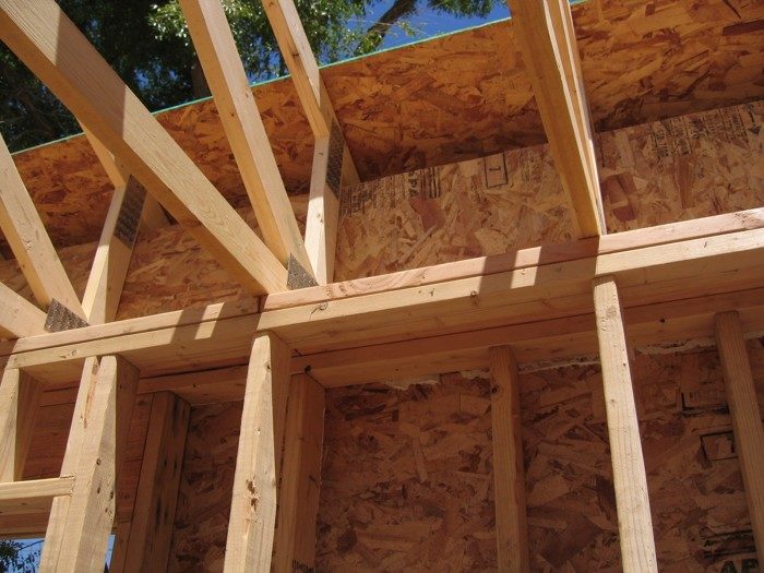

That's an attic truss, not really a raised heel truss - and looks like it would be a nightmare to insulate.
Response to Malcolm Tayolor
Malcolm,
Good catch. Thanks for your comment.
You're right -- the original photo that appeared with this article was a poor choice. I've replaced the photo with a more appropriate one.

raised heel truss
It's both an attic truss and has a raised heel, space below the attic floor is 16" deep to allow for blown in cellulose.
[Editor's note: Charles Bado is referring to the photo below, which appeared in an earlier version of this article.]
Raised heel truss redux
It does have a raised heels, but I bet it was incidental to any energy concerns. The height was necessary for structural reasons - as witnessed by the absence of any thought as to how the sloped top chord would be insulated. Unless the idea was to have an unconditioned attic - which seems like a lot of work for little return.
