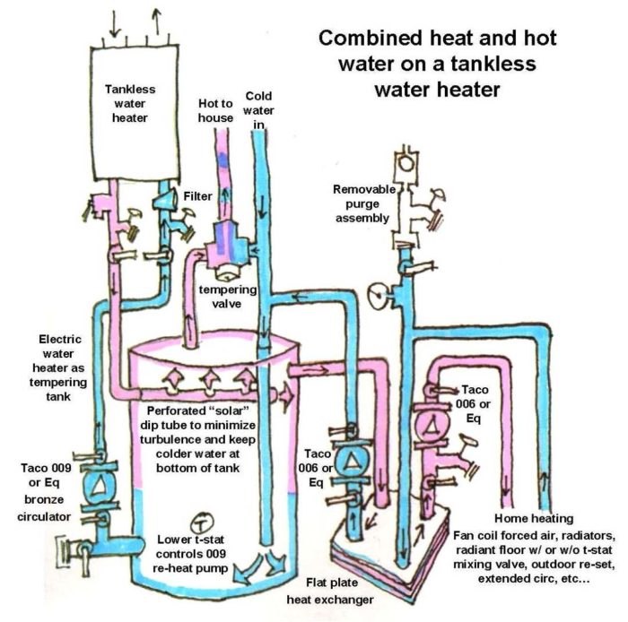

Image Credit: M. Chandler Our in-house combined solar/tankless heat and hot water system. Where the hot water recharge runs into the side of the tempering tank (at about 4-5 gpm), we now use a horizontally mounted perforated solar dip tube to keep from rolling the tank. The flow back from the radiant floor heat exchanger is not so problematic. After this session, I’ll be going to a Vertex tank or a minisplit heat-pump water heater.

The clogged intake filter problem seems to be related to debris coming from the anode rod. The problem is exacerbated by tank turbulence (AKA “rolling the tank” — when incoming water creates a current that sends hot water to the bottom of the tank and pushes cold water and sediment to the top). So using a smaller pump with a shorter run-time could reduce tank turbulence and help solve this problem.
I spoke about returning the water to the tempering tank using a horizontally mounted perforated “solar” dip tube to diffuse the flow and layer the hottest water into the top of the tank, to press the coldest water from the bottom of the tank to the tankless water heater.
The folks from Bosch proposed that plumbers just remove the filter after two months of operation, as their equipment only needs the filter in long enough to keep any teflon tape and pipe dope from jamming the flow. However, the Rinnai and Navien reps at the meeting didn’t jump on that bandwagon.
It’s Larry Weingarten’s turn
Larry Weingarten from Water Heater Rescue spoke of using a J-shaped cold-water dip tube to push debris up against the drain port, facilitating tank cleaning during maintenance.
Combined heat and hot water systems increase tank cycling and accelerate aging, so tank durability is an important part of this discussion. Weingarten stimulated a glorious conversation with graphic photos of tank failures and premature anode-rod decay. He proposed the idea of buying souped-up electrically powered anode rods and avoiding soft aluminum anode rods, and he explained how to tell the difference between magnesium and aluminum anode rods by looking for a bump on the nut (bump good, flatness bad).
Larry also sold me on using plastic-lined steel nipples to minimize corrosion in the transition between glass-lined steel tanks and brass or copper fittings. He also made a convincing argument to replace the plastic drain port at the bottom of the tank with a proper 3/4-inch ball valve and to take the time every year to flush the corrosive sediment.

Martin Holladay pointed out (vigorously) that we were all going around our elbows to get to our thumbs, by designing and fine-tuning these complex systems when we should just give up and admit that we need one appliance to heat domestic hot water and another to heat the home. (My lead plumber, Matt McDonald, points this out to me on a regular basis, much to my annoyance.) He also noted that most of the suggested modifications to tankless water heaters used for space heating — adding a storage tank, a huge intake filter, and a circulating pump, for example — complicated the systems in the effort to restore the advantages of a cheaper tank-style heater.
Martin loves wood stoves, solar water heaters, and wall-hung minisplit heat pumps, but he has a point. From my perspective, I just can’t imagine building a passive solar house without a well insulated slab floor, and I can’t imagine skipping the opportunity to put radiant piping in a slab and heating it with a water heater, especially with a solar tie-in.

Is the use of this tank(a converted,disabled electric hot water heater) because there is nothing available that may be better suited,say a small stainless steel indirect tank with coil?
And with regards to the tank,what determines the desired sizing of it? Could it be smaller than 10 gallons,larger than 10 gallons,much larger?Standby losses and short cycling of the tankless heater would seem to be a concern.
Thanks Michael,for all of your contributions,and I hope you can discuss this further or direct us to where these topics have been discussed recently.
