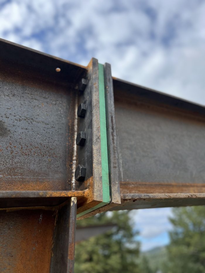

Because we didn’t want to upsize the heat pump condenser, we explored the option of adding a thermal break at the beam instead. That’s when we discovered Fabreeka’s TIM (thermal insulation material) thermal break, a load-bearing, fiberglass-reinforced laminate composite plate for installing between flanged steel connections.

We decided the best location for the 1-in.-thick thermal break would be in-line with the exterior sheathing. Here, we could cut the I-beam, weld a plate on each side of the cut, and bolt the assembly back together with the Fabreeka structural thermal break installed to the inside of the sheathing—in-line with the thermal control layer. The exterior metal plate is flush with the sheathing, and will be covered with a WRB and siding.
To conceal the thermal breaks without compromising the home’s aesthetics, we installed the TIM plates beyond moment-frame connections and within the thermal barrier, thereby concealing them inside the wall assembly.
Installed Fabreeka TIM
Installed Fabreeka TIM. Photo courtesy of author

Executing this detail required collaboration with an engineer experienced in commercial projects to ensure structural integrity. We had to increase the scope of work to account for the additional time needed for detailed calculations and coordination with welders; we even had to work with a countertop shop to cut the Fabreeka TIM panel with their water jet cutter.
By charging per hour, we were able to avoid the over estimation or so-called “learning tax” that many vendors use when faced with estimating a new product. (To incentivize buy-in from trade partners, we transparently communicated the necessity of the detail and tracked the time it took to complete this additional work.)
By fabricating thermal breaks using Fabreeka’s TIM, we reduced the BTU load so we could correctly size the HVAC equipment. We estimate a cost savings of between $12,000 and $22,000 for the homeowner, whose house now has a much better chance at achieving optimal thermal performance.
