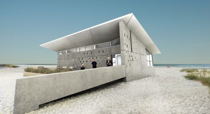

Image Credit: Rutgers: the State University of New Jersey and the New Jersey Institute of Technology Sunlight reaches the eNJoy interior through punched openings in the concrete panels, clerestory windows on the north and west walls, and large windows on the south wall (visible here in the dining and common areas). The target buyers for eNJoy are couples who want to live on or near New Jersey’s Atlantic coast. Mechanical components will occupy a portion of the building’s central core. Precast concrete panels comprise most of the shell, including the roof. The view from the main entry of the house. The north and west walls of the house are topped with clerestory windows. The exterior walls off the kitchen, dining, and common areas feature a lot of window space. The deck near the main entrance, on the north side of the house.
The target market for Team New Jersey’s entry in the 2011 Solar Decathlon is a couple (perhaps retired) who wants a small, durable, energy-efficient house suitable for the Jersey shore. And in practical terms, trying to appeal to home buyers longing for respite somewhere along New Jersey’s long, lively, and mostly pleasant Atlantic coastline probably isn’t a bad idea, provided you’re willing to put up with allusions to MTV’s “Jersey Shore.” It’s unlikely the members of Team New Jersey – a collaboration of students and faculty from Rutgers: the State University of New Jersey and the New Jersey Institute of Technology – weren’t expecting joking references to the show (are there any other kind?) and other digs at Jersey Shore pop culture. But they’ve become experts at deflecting snark by steering attention to the amenities of the home, dubbed “eNJoy: A Generation House.” The 960-sq.-ft. one-bedroom house has a shell of precast concrete panels and an inverted hip roof that, with its large overhang, is designed to maximize rainwater collection.

Despite all the concrete, eNJoy aims for a stylized contemporary look – a solid form with small punched openings to let in light, although most of the daylighting comes from a long line of clerestory windows on the north side of the house and a contiguous stretch of large windows on the south side. Hvizdak points out that the large inverted hip roof gives homeowners significant flexibility when placing the building’s photovoltaic panels and solar hot water collectors for optimal exposure. As on a flat roof, the PV and solar hot water panels on eNJoy, when installed on angled mounts, can be grouped on the north or south portions of the roof, depending on surrounding foliage, to maximize exposure to the sun. The building’s electrical system, HVAC appliances, and plumbing will be concentrated in a central core – in one of three modules that will be bolted together to form the main structure. From NJ to DC and back Once it has prepared them for shipping, the team will load the three modules, along with the PV array, entry ramps, decking, and landscaping components, onto a total of seven trucks. The team expects to take about two days to reassemble the house on the National Mall in Washington, D.C. Upon its return to New Jersey, the house will be offered for sale. Construction costs are expected to be about $300,000, although Clinton Andrews, a professor at Rutgers and one of the project’s faculty leaders, told the CourierPostOnline, which covers southern New Jersey, that about $100,000 could be trimmed from those costs if the house were to go into production. We’ve asked the team for more details about the materials and mechanicals used, and the expected performance of the building. Whether the eventual buyer of the prototype is in fact a couple interested in a spot near the Atlantic shore remains to be seen, although the team certainly would entertain an offer from MTV. “If they were the ones to buy the house,” Hvizdak told Fine Homebuilding, “it would be OK.”
