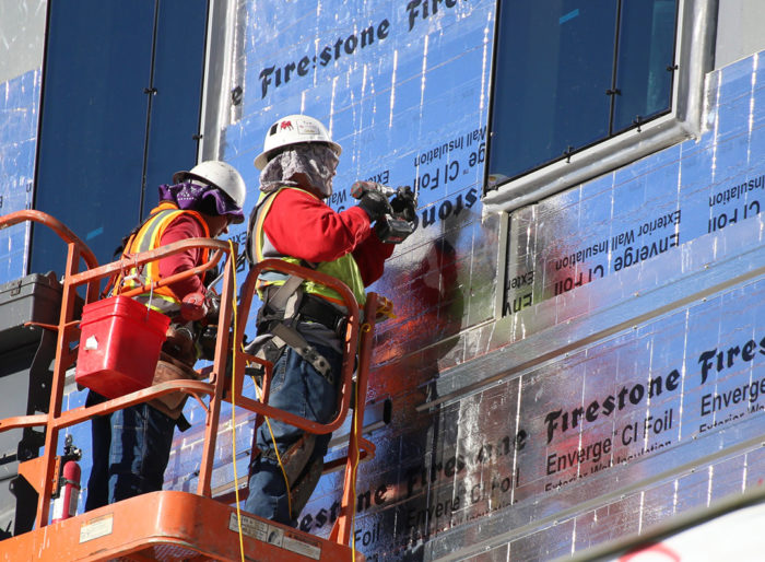

R-value tests by the National Roofing Contractors Association and the Building Science Corporation have revealed that the thermal performance of polyisocyanurate is greatly reduced at cold temperatures. While the R-value of polyiso at a mean temperature of 75°F might be about R-5.7 per inch, the effective R-value of the polyiso drops to about R-4.8 per inch at a mean temperature of 25°F.
Over the past three years, GBA has published several articles on this problem. (See, for example, In Cold Climates, R-5 Foam Beats R-6 and Cold-Weather Performance of Polyisocyanurate.) As builders have learned that polyiso wasn’t doing as good an insulating job at cold temperatures as they had thought, they’ve started to ask questions, including:
