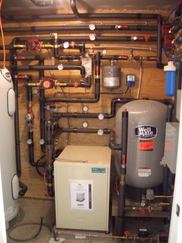

Designers of energy-efficient homes — especially homes aiming for net-zero energy use — must inevitably grapple with the question of simplicity versus complexity.
Residential designers can choose from an array of sophisticated appliances that improve comfort and help homeowners reduce energy use. Examples include heat-recovery ventilators (HRVs), condensing boilers, ground-source heat pumps, solar hot water systems, on-demand water heaters, heat-pump water heaters, photovoltaic modules, and co-generation systems.
Most of these devices perform well. However, designers who specify sophisticated appliances need to consider the trade-offs that accompany such hardware:
- Higher upfront costs;
- The need for proper commissioning; and
- The need for proper maintenance.
