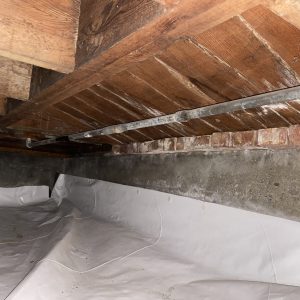

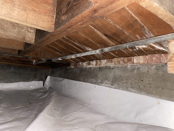

![](http://images.greenbuildingadvisor.com/app/uploads/2023/03/05162918/vented-crawl-space-nasty-wet-700x420.jpeg)
Vented crawlspaces are often nasty, dirty buffer spaces that can flood your home with a variety of indoor air pollutants. A lot of it starts with moisture, of course. Water comes up from the ground beneath the crawlspace, sometimes in strange ways. It comes straight through the foundation walls. And it can come in with outdoor air that’s intentionally vented into the crawlspace. In many cases, the best solution is to encapsulate the crawlspace. But when should you encapsulate your crawlspace? And when should you not?
