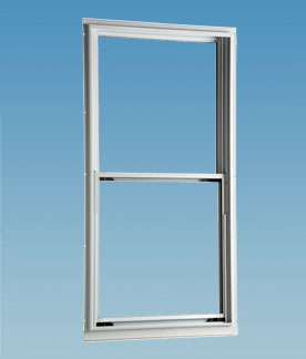

If your windows are a fairly standard size, it may make sense to replace just the sash rather than the whole windows. Sash replacement is a lot quicker and less expensive than whole-window replacement. If you replace older double-hung sash with new, your contractor may be able to remove the sash weights and insulate those sash-weight pockets (insulate with low-expanding foam sealant).
If your existing single-glazed windows are in reasonable condition and replacing the sash isn’t an option, installing storm windows often makes sense—this isn’t an option with casement or awning windows. Adding storm windows may even make sense if you have insulated glass in your prime windows, though the economic payback won’t be as fast.
I recommend outside-mounted, high-quality, triple-track, aluminum-framed storm windows. Quality is important, as they get a lot of wear-and-tear; triple-track means that there is an integral screen. Look for storm windows with low-e glass to boost performance. Harvey Industries, based in Waltham, Massachusetts, custom-manufactures such storm windows, though they have to be ordered through a builder or remodeler.
Since the low-e coating on a single-pane storm window will be exposed to air, it has to be a “hard-coat” low-e, which is more durable than the more common soft-coat low-e coatings. I have long looked for a quality insulated-glass storm window—so that you would end up with triple-glazed performance—but I’m not aware of any such product.
If your budget is too tight for new, high-quality storm windows, you might want to consider a less expensive, plastic, interior storm panel. If relatively handy with tools, you can make these yourself using materials available from Brown & Roberts or one of the local home centers. You can also order prefabricated, interior storm panels, such as those made by AEP Window Solutions, just across the Vermont border in Hoosick Falls, New York (518-686-9581). AEP custom-makes lightweight, removal, insulated panels (two layers of plastic) to fit your window frames at a significantly lower cost than replacement windows. The most budget-conscious homeowners or renters can simply tape or staple plastic on the inside of the windows—as I used to do—but this isn’t a permanent fix and it’s ugly.
Finally, you might want to consider repairing and air-tightening your existing windows—this can be done whether or not adding storm windows. Tom McLoughlin has recently moved to Brattleboro and set up a business specializing in window restoration. Thomas McLoughlin LLC Window Restoration (254-9370) preserves existing double-hung wooden windows, maintaining the historic character, while making them functional again and adding all-important weatherstripping.

We have original wood sashes in fair condition, but worth restoring since all of the interior oak window trim is unpainted and in very good condition. Our home is a 1920 Craftsman four square. We had wood frame storm windows made locally with double pane, insulated glass, low-E coated with warm edge spacers, for about $110/window. I had to paint the pre-primed frames and add the hardware to hang them, but we are extremely happy with their performance (foam weatherstripping seals them tightly). This is a simple, low-impact solution for older homes.

There is a company in Utah that makes a double pane polycarbonate window insulator that has an integral frame/gasket that holds it in place and seals at the same time perfect for historic because it does not attach in any way yet increases performance 15-50%. Check out http://proactiveenergyconcepts.com/index.html As a green builder/remodeler I recommend them because they provide a solution with the best ROI because you are sealing and insulating your windows without having to change them.
