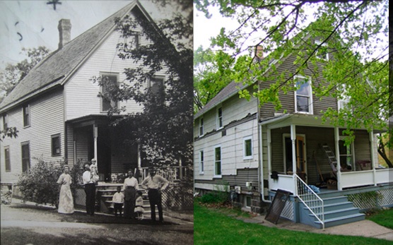

Matt and Kelly Grocoff’s house, a Folk Victorian in Ann Arbor, Michigan, fits comfortably in their neighborhood’s 19th century architectural vernacular. But the Grocoffs purchased the 110-year-old building, in 2006, for more than its decorative appeal and its place in Ann Arbor’s vaunted Old West Side Historic District. One of the real selling points, especially for Matt, was that house was something of a mess.
“It was a dream come true,” Grocoff, founder of GreenovationTV and the green renovation expert for Old House Web, says in an OHW video about the house. “It had lead paint, asbestos siding, zero insulation, and even an old gas-powered lawnmower out in the shed!”
Playing off the notion that the greenest house is the one you don’t build, Grocoff is using the upgrades to the Victorian to show how deep an energy retrofit can go in a house that not only is very old (by U.S. standards) but subject to relatively strict historic-district rules for renovation. It has turned out to be a long-term project, to say the least, but if Grocoff has his way, the house will soon operate at net zero energy. And because he and his wife (who have a young daughter) plan to stay in the house indefinitely and live in it as it makes its crawl toward better energy efficiency, Grocoff has been justifying many of the improvements by factoring in prospective savings on energy costs and preservation of original materials.
