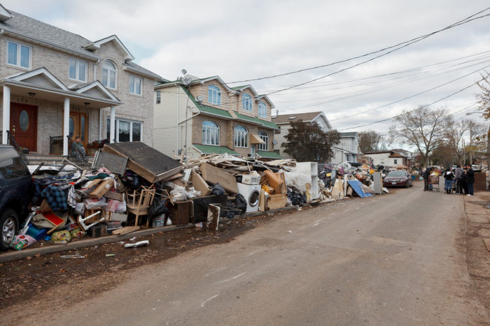

The Natural Resources Defense Council has released a groundbreaking report, Seeking Higher Ground, that takes a hard look at the plight of people whose homes are repeatedly flooded and the difficulties they face in acquiring assistance to move somewhere safer.
Under the National Flood Insurance Program (NFIP), a federal disaster aid program administered by the Federal Emergency Management Agency (FEMA), some of the most flood-prone properties in the country have been repeatedly rebuilt even when it would be less expensive to help homeowners move to higher ground. NRDC has proposed an innovative program that would guarantee a homeowner a buyout of their flood-prone home, enabling them to move to a safer location in the aftermath of a flood.
Since 1978, more than 30,000 properties have been flooded so often they’ve been designated “severe repetitive loss properties” (SRLPs) under the NFIP. That’s not a designation any homeowner wants. On average, these properties flooded five times every 2 to 3 years. Some of the most affected properties have flooded more than 30 times. In each case and after every flood, the NFIP paid to rebuild the property at a cost of $5.5 billion.
Today there are thousands of these properties. In the coming decades, our analysis indicates there will be millions of these properties as a result of sea level rise and the impacts of climate change.

(1) Since 1978 there have been more than 30,000 SRLPs. These properties represent 0.6% of all NFIP policies (5.1 million policies), but a disproportionate 9.6% of all flood damages ($57 billion since 1978).
(2) The homes of low and moderate income owners are more likely to incur damages that exceed the property’s value. For single-family homes worth less than $250,000, the average home is worth $109,882, but suffers $133,923 in total flood damages.
(3) In coming decades, sea level rise may cause as many as 2.5 million properties to repeatedly flood and the NFIP could pay as much as $447 billion to repeatedly rebuild before they are finally inundated.
(4) In many instances, it would be less expensive to help these homeowners relocate to higher ground. Among the 2.5 million properties at risk, as many as 1.6 million cost less than $250,000 and their owners could have their homes purchased for less than the anticipated damages.
