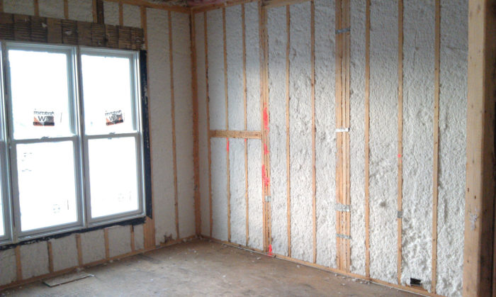

What's with the tripled & quadrupled up studs?
The picture at the top looks like a good example of how NOT to frame a house for decent thermal efficiency! No matter how well the fluff get's installed, there's no getting around the excessive thermal bridging.
https://www.greenbuildingadvisor.com/sites/default/files/7692469192_2c29a2de8c_k.jpg
Built-up Posts
How would you transfer point-loads to the foundation without multiple studs?
Structural members
I would no be as quick to judge the first picture... I've had to do the same on many instances, usually because of structural load bearing. It could be that there is a double or triple girder to a second floor with a 24'-30' span which is carrying a full roof bearing load with a habitable attic and tile roof.
It does appear to have good insulation installation and calking around the plates and corners. I would say this picture shows a better job than 98% of jobs I see in the field.
@Dana,
Pffft !!! That's nothing. I have photos of new construction where there are ~6 , yes, 6 studs on each side of a window. Each seam is sealed with foam of course (sarcasm). Ya know so it'll pass the code-mandated blower door test .
Just another reason for exterior insulation.
@Malcolm
Would using 2x6's reduce the number of studs?
Chris
It depends on what it is holding up. Our code specifies that the posts must be at least the same width as the beam being supported, so if it's say 3.2"x10's than you need three studs, whether they are 2"x4" or 2"x6". If it is supporting a narrow engineered beam, like an LVL then perhaps going to 2"x6"s might allow you to use less.
