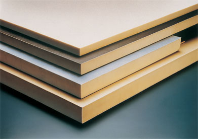

In this final installment about insulation we’ll take a look at the family of rigid boardstock materials. Unlike fiberous or spray-foam insulation that is installed in wall or ceiling cavities between the studs, rafters, or joists, boardstock insulation is applied either on the interior or exterior surface, spanning across the framing.
The three most common types of rigid boardstock insulation are plastic foams: extruded polystyrene, expanded polystyrene, and polyisocyanurate. Extruded polystyrene (XPS), including the familiar light-blue Dow Styrofoam and Owens Corning’s pink Foamular, is the most moisture-resistant of these three and is commonly used below-grade to insulate the exterior of foundation walls and under basement slabs. XPS provides an insulating value of R-5 per inch. Unfortunately, XPS (in this country) is still made with ozone-depleting HCFC blowing agents, which manufacturers are required to eliminate by 2010. Manufacturers of blowing agents, refrigerants, and other compounds have made great progress in eliminating substances that destroy the Earth’s protective ozone layer in the stratosphere since the hole in the ozone layer above Antarctica was discovered in the 1980s. XPS is the only insulation material still made with ozone-depleting blowing agents.
Expanded polystyrene (EPS), also known as beadboard, is manufactured more locally by smaller companies than is XPS, and it can be purchased in a much wider range of dimensions, thicknesses, and densities. The most common EPS, with a density of about 1 pound per cubic foot, doesn’t perform well below-grade, but it can be ordered at higher densities that do much better in such applications. For below-ground use, I recommend at least 1.5 pounds per cubic foot. Two-pound EPS is even better, with performance much closer to that of XPS. The most common low-density EPS insulates to about R-4 per inch. It is manufactured with pentane as the blowing agent, which does not harm ozone. EPS is the most common insulation material used in producing structural insulated panels, such as those made locally by Winter Panel Corporation and Foard Panel.
Polyisocyanurate is the highest-insulating boardstock option, providing R-6.0 to R-6.5 per inch. A special low-conductivity gas fills cells in the insulation, and foil facing slows down the loss of this gas or entry of air—a process that, unfortunately, reduces the R-value somewhat over time. This gas fill or “blowing agent” used to be an ozone-depleting compound, but manufacturers have shifted to ozone-safe blowing agents, usually pentane.
Polyisocyanurate is most commonly used for roofs and walls, but almost never below ground because it can absorb moisture.
In addition to these three rigid-foam boardstock materials, there are also rigid fiberglass and mineral wool boardstock insulation products. These are excellent in the right applications, but they are usually only available for commercial construction; they are not carried by most building supply centers serving residential builders and homeowners.
