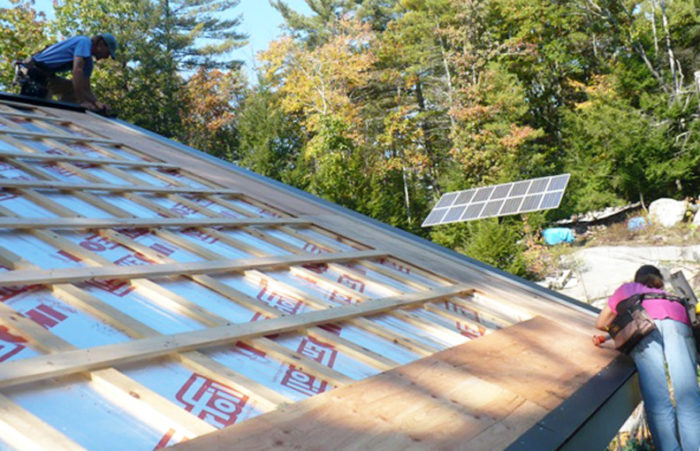

Anyone who is contemplating a deep energy retrofit has to consider multiple approaches and techniques for taking the diverse building stock we have and transforming it — from the standpoint not just of energy use, but also comfort, health and safety, and durability — because so much of our building stock is plagued with deficiencies. Retrofits fix the issues with the building — and saving energy almost ends up as a desirable byproduct.
If energy saving is the principal goal, it’s important to look carefully at the choices the occupants make. Energy in buildings goes to more than heating and cooling, which are the main loads that retrofits target. Over forty percent of primary energy in U.S. homes goes to non-thermal loads.
Once we superinsulate a house in New England, energy for heating, once the largest load by a comfortable margin, may become the smallest load among heating, domestic hot water (DHW), and plug loads/lighting/appliances (PLA). To get to truly low energy performance then requires focus on domestic hot water and PLA loads.

What a deep energy retrofit gets that the other strategy (targeted weatherization and behavior-based deep energy reductions) may not is relief from the non-energy deficiencies — ice dams, pest infestations, water issues, mold, etc. — and true comfort. The cost of remediating those defects shouldn’t have to be paid for solely by the energy savings that accrue.
