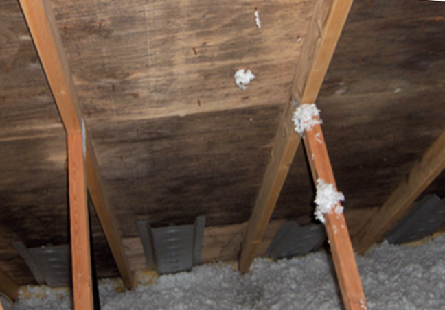

Mold growth on the underside of roof sheathing has become an epidemic in the Pacific Northwest. So what's the solution?
Image Credit: All images: RDH Building Engineering
Sloped roofs over ventilated attics are one of the most common, if not the most common, roof configuration in Canada. This type of roof assembly is typically associated with single family houses but they are also commonly used on townhouse complexes and large architecturally complex multi-unit residential buildings.
I work for RDH Building Engineering in British Columbia, Canada. RDH has investigated hundreds of attics throughout the Lower Mainland of B.C., and mold growth on the underside of the sheathing is a common condition.
In many cases, the mold can be attributed to condensation associated with air leakage from the interior space or ductwork, or the re-entrainment of humid exhaust air from poorly terminated ducts.
However, the problem has also been noted in attics that do not have obvious extraneous moisture sources and that are generally ventilated in accordance with the requirements of the building code. Interestingly, the problem is often more significant on north-facing elevations than on south-facing elevations.

The primary objective of the study was to demonstrate that well-constructed sloped wood-frame attics in the coastal climate experience moisture-related problems even in the absence of interior moisture sources and with unrestricted ventilation.
After monitoring from September 2012 through March 2014, we noted that the moisture content of the plywood sheathing in all of the roof huts ranged from 20% to 30% during the rainy fall through spring months. The moisture content is consistently maintained at cautionary levels for fungal contamination (above 20%) for the winter months (see graph below).
The moisture content of the sheathing is closely related to the outdoor climatic conditions, notably exterior temperature and relative humidity. However, we also concluded that the moisture content of the sheathing increases due to condensation on the underside of the plywood when night sky radiation depresses the temperature of the sheathing below the dew point of the ambient air.
As seen in the photos below, this condition generally occurs when there is frost on the roofs and the air temperature remains above freezing. The condensation results in liquid water on the surface of the sheathing and on the nails used to attach the shingles. The presence of liquid water, even if for short periods of time, supports mold growth.
Mold growth occurred on the underside of the plywood sheathing on all of the roof huts within the first year. As anticipated, mold occurred initially on the north elevations because of the reduced solar warming.

    This very interesting, as most of the discussions about damp sheathing assume a climate where when the plywood has a high moisture content the temperature is too cold for mold growth. But here in the PNW that isn't the case. Mold grows on the north facing sheathing of my uninsulated shed which is completely sheltered from rain, and the north face of my ventilated attic, but to a much lesser degree that that shown in the blog.
    Eliminating the roof sheathing in favour of purlins under a metal roof isn't an option, as it is precluded by our seismic code.
    While the mold in the photographs looks disturbing, I wonder to what extent it affects the structural integrity of the plywood, or is associated with other decay? Being outside the conditioned envelope, how much of a health concern is it?
    My experience with these roofs is that if you remove the shingles there is no mold growth on the top side of the plywood. i wonder if simply encapsulating the underside surface with a treatment like a Concrobium spray would be enough to inhibit this happening? Hopefully their research will tell us shortly.
