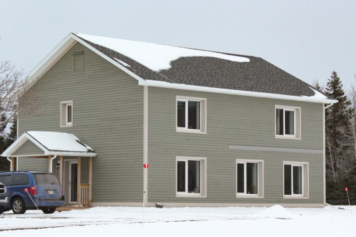

Beth and Ralph Peters and their four children have just passed the one-year mark in their new home on Prince Edward Island, and can report that their energy-saving efforts have more than paid off. The total heating bill for the year, all 754 kilowatt-hours worth of it, was $99.23. That’s pretty good for an area that sees about 8,000 heating degree days a year.
The family used a total of 10,029 kWh of electricity — about $1,872 worth — for all purposes during their first year of occupancy.
The Peters family is living in a house built to the Passivhaus standard. The house would have been the first Passivhaus building in the province if the owners had pursued certification. The $5,000 plus cost of certifying the house was more than their budget allowed, but they’ve been reaping the rewards nonetheless.

- Exterior walls: The 21-inch-thick walls are comprised of a structural 2×6 assembly and an outer 2×4 joined with webs of OSB. Between the 2×4 and 2×6 bottom plates is a 6-inch space, and on the inside of the 2×6 wall there is a non-structural 2×4 service wall. All cavities are filled with dense-packed cellulose to R-60. Wood siding was installed over a vented rainscreen gap.
- Roof: Raised-heel trusses insulated with loose-fill insulation to R-74.
- Ventilation: A Zehnder ComfoAir 350 heat-recovery ventilator provides fresh air for the house. What the blog describes as a “poor man’s geothermal” system, a 500-foot long tube filled with glycol and buried 6 feet in the ground, tempers incoming air in the HRV. (For more information on this type of glycol loop, see Using a Glycol Ground Loop to Condition Ventilation Air.)
- Domestic hot water: Tank-style electric resistance water heater.
- Windows: Klearwall triple-glazed tilt-and-turn vinyl windows manufactured in Ireland. Windows are set at about the midpoint of the wall.
- Air leakage: In exterior walls, the air barrier is a layer of taped OSB just to the outside of the 2×4 service wall; in the roof, a membrane made by Mento is the air barrier. A blower door test measured air leakage at 0.21 air changes per hour at a pressure difference of 50 pascals.
- Energy use: Total energy use during the first year of occupancy was 10,029 kWh. Interestingly, the family used 6 times as much energy for heating domestic hot water as they did for space heating. Energy monitoring showed that the Peters used 4,741 kWh for miscellaneous electrical loads (including lighting), 4,534 kWh for the water heater, and 754 kWh for the electric space heating element. A spreadsheet showing monthly energy use is posted at the blog.

The heating in an 8000 degree day zone in a 2000 sq ft house is 754 Kwh per year! Well, as much as I love this number I do have to express slight puzzlement. A passivhaus would require 2930 kwh or less for a house this size. Now if they heated with a heat pump then yes, I could see it, but they don't, just an electric heater. The "poor mans heat pump" certainly does miracles in conjunction with the Zehnder. If the numbers are in fact correct it would mean that this house could get through the winter on pure PV array of about 12 kw without grid supplement. And I mean, not just net zero, but real time production in winter. Their general use of electricity though, is on the high side at 10,000kwh year.
Amazing, but believable
Ven: The house is insanely airtight and very well insulated. Not many windows. I believe the heat number, as unbelievable as it sounds.

Regarding the believability of the energy use, don't focus exclusively on the 754 consumed by the space heater. A high percentage of the 4741 miscellaneous electrical loads would end up as heat even though it does some other useful stuff in the process. Also, not all of the 4534 consumed by the water heater literally goes down the drain.

I always create a full set of construction plans including floor plans, elevations, window/door schedules and a detailed cross section. Construction details are drawn on an, "as needed," basis. Many builders in our region develop their own techniques for building details so comprehensive drawings, that likely will be ignored, are a waste of resources. I always have a conversation with the builder to develop plans suit to his/her needs. Plans are revised to suit these needs.
Larsen Truss OSB:
The continuous OSB on the Larsen truss is, as Martin pointed out, to facilitate hard pack insulation installation. Continuous OSB is much faster than adding another detail to the Larsen truss construction process. The thermal bridge for 1/2 inch OSB over the wall thickness models as insignificant. There is also a thermal break provided by the offset insulated service cavity.
Engineering:
There were no engineering details needed for this project. Sometimes building officials will require engineering details for the structural slab. The wooden structure fully complies with the building code so there is no need for engineering. The Larsen truss is considered to be structure beyond the building code. The floor system and roof trusses are engineered, in house, by suppliers.
Energy Accounting:
I agree that waste heat from, say light bulbs, can provide heat to the house. I hope, however, the successes of this Passive House project will be recognized fairly. Many other things could have been done (such as DHW heat recovery, solar DHW, PV...) and still can be added. I always advocate for investing in the envelope, windows and ventilation first as these things build a better, more comfortable, more resilient and healthier house. It is also a pain to add these things later. Most other things can be added at a later date.
To give perspective on where this house stands to the norm I provide a comparison based on estimates (from NB Power, the New Brunswick power utility) for a similar house built to code and with typical occupant behavior in our region.
Typical New Brunswick House (2000 sq ft, 5+ occupants, code built, < 5 years old):
Heating only: 12,592 kWh
All other uses: 14,046 kWh
Total: 26,638 kWh
Based on these number the Peters family is already using 34% less than the norm for non-heating electrical consumption. For space heating they are using 94% less! Overall the Peters - a family of six - use 63% less electricity than the norm - pretty impressive no matter what column you put the numbers in!
